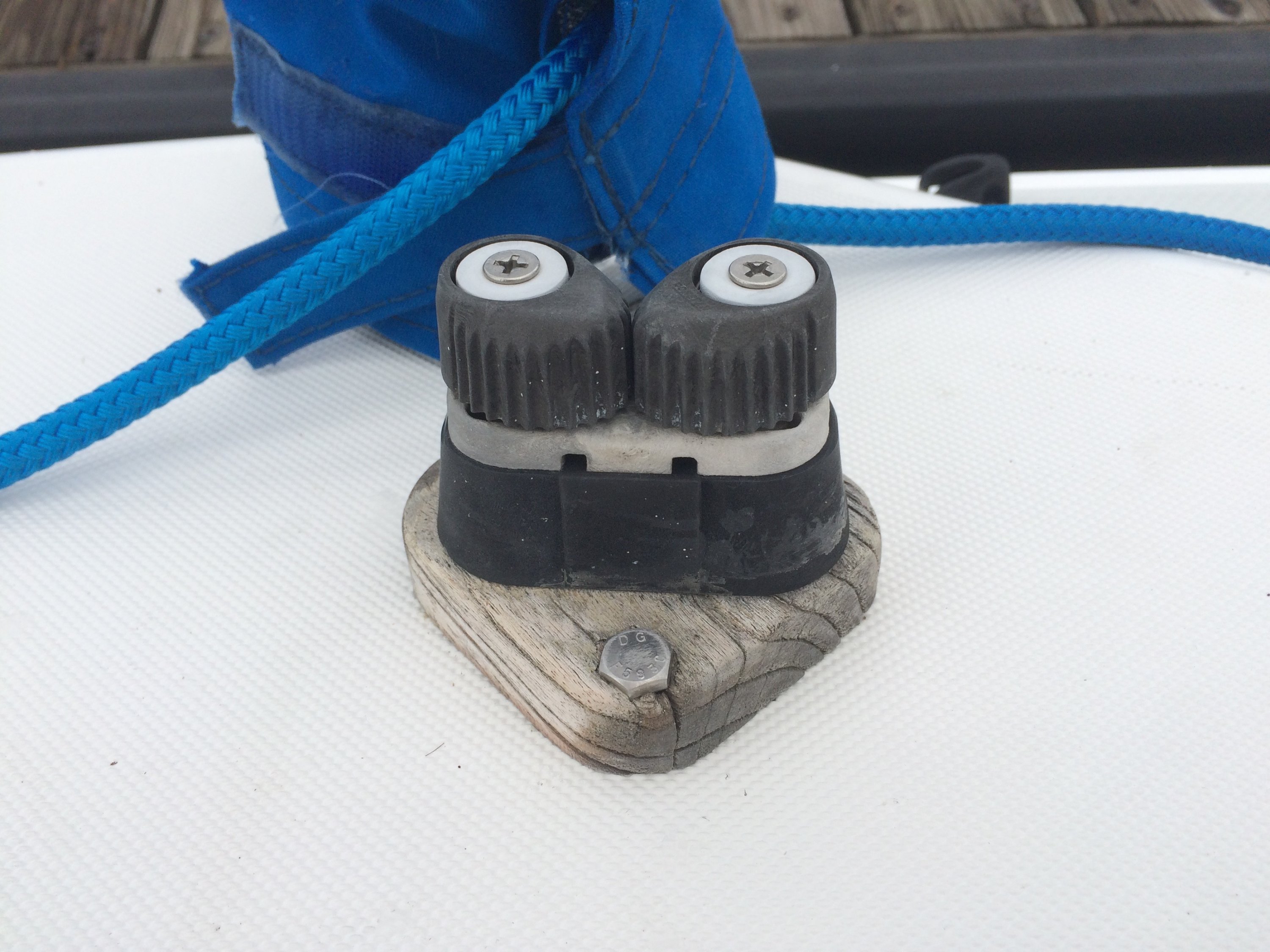

I have had many good suggestions on how to better control boat heal on this forum (thanks) but have a question on setup. The appended pic shows that I have a cam cleat for the sheet next to the winch. This works great but the line is very difficult to release under stress, i.e., exactly when I want to if I start to feel "uncomfortable" while the boat is healing. Any recommendations for a better set up that allows easy release under tension.

Pulling straight up does not pull it out quickly? Cam cleats are kind of the standard for securing the jib sheets if you don't have self-tailers. Maybe someone has a different design that works better but a good yank upwards should pull it out.

Your's looks fine. Theoretically, you should be able to release the sheet by just yanking the sheet upward... but it can be difficult when sheet is under a lot of tension. Cam cleats work better if you pull back and up. If you can't pull back under load... wait till the sail starts to luff to relieve a little tension.... Or you can stick the handle back in the winch and grind it back a tad to release... then remove handle before throwing off the sheet. When you're ready to cast off completely.... pull the sheet straight up off the drum... don't try to unwind it.

I agree with John VTX about releasing the main first. But if you want to release the jib and it's too tight to pull from the cam cleat, maybe you need more wraps on the winch. If you have 4 wraps the cam cleat shouldn't have to do too much. Many boats have a horn cleat and typically one wrap around that is adequate. If 4 wraps doesn't pretty much hold the sheet on the winch look at the winch. Maybe the knurling or friction finish need redoing.

I agree with Joe, pull back & up. Pulling straight up doesn't help release the load from the cam. It works the same way setting the line in the cam. You have to pull back and down simultaneously. Usually, it's harder to get the hang of the motion when setting the line in the cam than it is releasing the line.
If you are loaded to the extent that you can't pull back, you've got too much load on your sail, especially for a small boat. Or, perhaps the winches need servicing?

With three or so wraps, you should have enough friction on the sheet/drum to allow it to be pulled up easily. This means that the winch (correctly) is bearing the load of the sheet. Too few wraps and the the cleat is holding it. Not good for the cleat, or you.

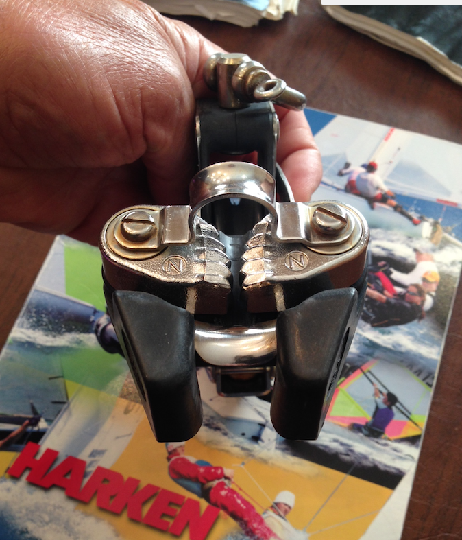

Harken makes a cam cleat with a mechanism that allows the cams to be easily opened under load by just applying downward pressure on the sheet. They work really well. I fitted a main sheet block with one of these because I was having problems releasing the sheet in high winds. The hardware is sold by Harken as a Nash Trigger Cleat. They are still available. Here is what it looks like.

Thanks, as usual, for all the feedback. In reading all of this, I think that I need to add another wrap on the winch (I have been using 2). Based on prior discussions, I have been easing the main to control healing, which works well. Then I go to the jib, although sometimes I only fly the jib. So releasing it has been troublesome at times, but the suggestions here will likely help. My primary issue (other than not having the faintest idea of what I am doing :)) is that the wind on Lake Dillon shifts quickly and often, from dead to gusts that come off the mountains; this is how I got knocked down. SO, I often sail with the main sheet in hand, ready at a moments notice. I suppose that this is what experience is for!
