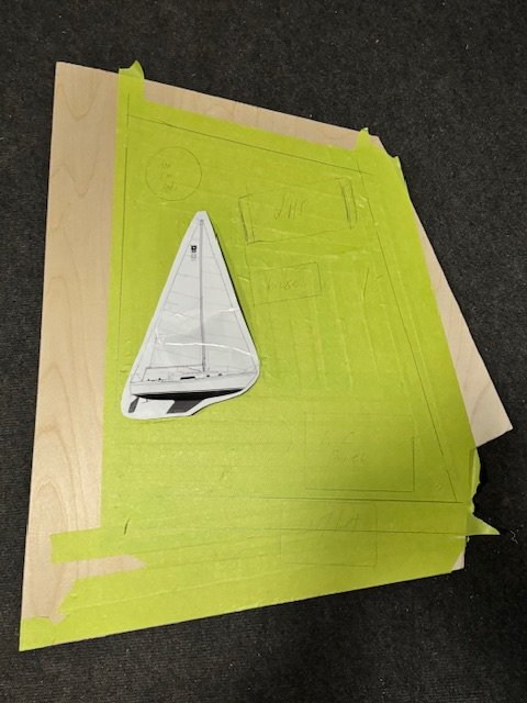

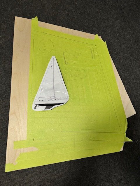

Also worked on my electrical panel redesign.
I might work on placement of components again, let me know what you all think so far.
the contour lines are the cut out lines, this part will be hinged to open it and work on it
edit:
I see the picture’s line are pretty light, I will redraw them with a sharpie and repost the picture
