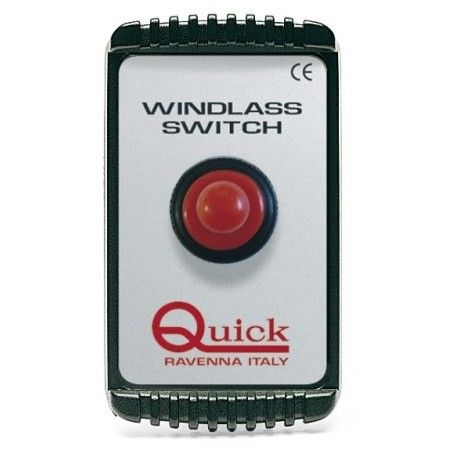

On our 343 it to right of the battery switches it is a
DC Thermal Circuit Breakers - Panel Mount if the little arm is out it is tripped. I don’t know how to load a pic but if you check in the online store here they have a picture

Yes I agree it’s a bad location we were out one day and went to drop the anchor and nothing. I tracked it down and I think someone hit the red button which tripped the breaker. Reset the breaker and all was good

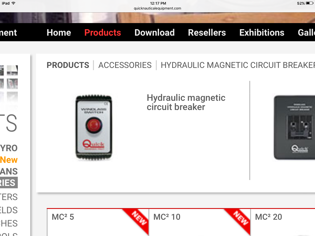

The Quick on line store shows these (see picture) circuit breakers. Is that what mind should look like on my 2009 B37? If so, I don't see anything like it..........so far!
Feb 20, 2011
8,062
Can you provide a link to the Quick online store?
Is a "switch" a "circuit breaker"?
Hmm, "hydraulic magnetic circuit breaker".

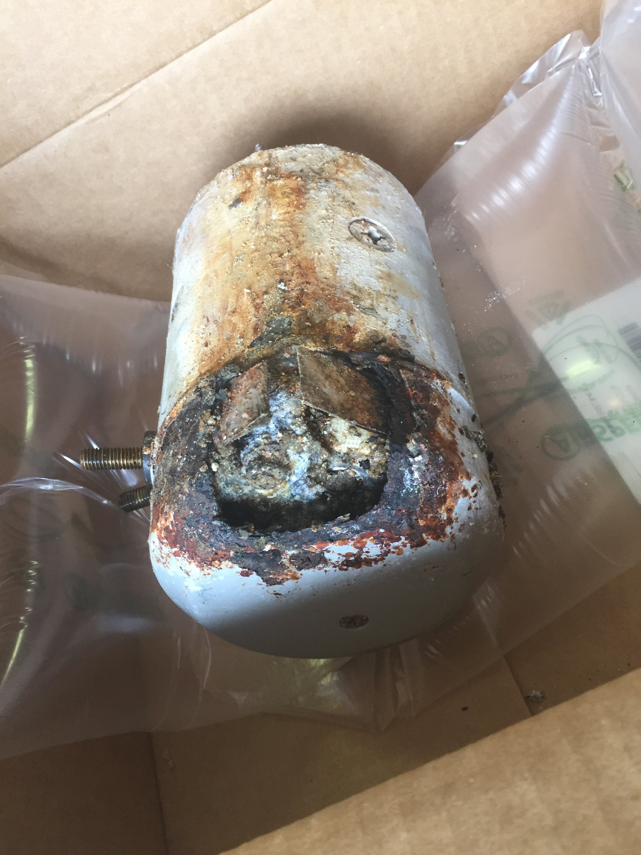

PROBLEM IDENTIFIED: I finally got around to pulling the windlass off. The motor is in a black plastic case, and looked ok thru the small window in the black case where the cable connections are.........BUT, behold what I found when I pulled the motor out of the plastic case!

Ouch! But at least not a mystery. The same thing was on its way to happening to our Lewmar windlass when we got our 331 five years ago. The motor housing was quite corroded, but not near the extent of yours! And luckily the Lewmar had no plastic cover to hide the issue. I was able to bring the motor home, clean off the corrosion and repaint. I take a look in that compartment periodically so as not to get surprised again, and three years later it's still fine,
Oct 26, 2010
2,214
Hunter 40.5 Beaufort, SC
Looks like you've got a nasty leak somewhere that allowed that corrosion to occur. I am sure you realize that you'll need to sort that out first or you'll be looking at the same thing in a few years.

Yes indeed! The Aleph model I bought has a different type seal system for the incoming power cables....hopefully that will make the difference!

Not sure of the design of the winch location in your Bene but it seems odd that the power cable entry point or seal would even be run in a way that they are exposed to being able to leak into where the motor is housed? That seems like a really poor way to design it. I know that on my boat, the anchor windlass motor is inside of a completely enclosed space that is never exposed to the elements and the penetration is only the shaft from the motor to the capstan. Your picture doesn't show how the motor is attached but I'd be looking for why the installation even has the power cables in a position where there is a seal required for them. Was the winch installed at the factory or installed after delivery?

PROBLEM IDENTIFIED: I finally got around to pulling the windlass off. The motor is in a black plastic case, and looked ok thru the small window in the black case where the cable connections are.........BUT, behold what I found when I pulled the motor out of the plastic case!View attachment 149016
It looks like the OEM gets $650 for a replacement motor in that size.
http://www.quickusastore.com/windlasses-14/spare-parts/windlass-electric-motors.html
Even as bad as that motor looks, I think that I still might try to find a local motor shop that can do a rebuild. I've had rebuilds done at shops here, in NY, in Houston & in Toronto. In all four shops, the results were at least as good as new.
That motor needs a brush plate, bearings, brushes, seals & an end cap. The frame & magnets are probably still good. If the armature is still OK, then the motor is probably worth rebuilding.

It is mounted inside a plastic case, but the case is in the anchor locker, attached at the top of the deck.
