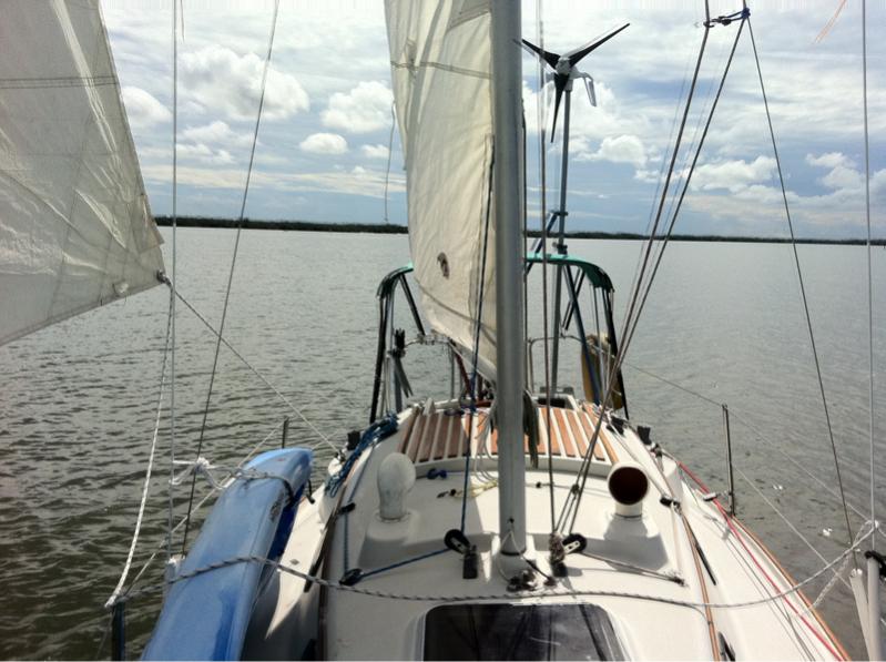

I use an autohelm 3000. I also have wheel steering and it is very effective at holding a course. These are older devices that just keep running and most importantly they use very little power.
Out there using it today. It is steering while I take pictures.
