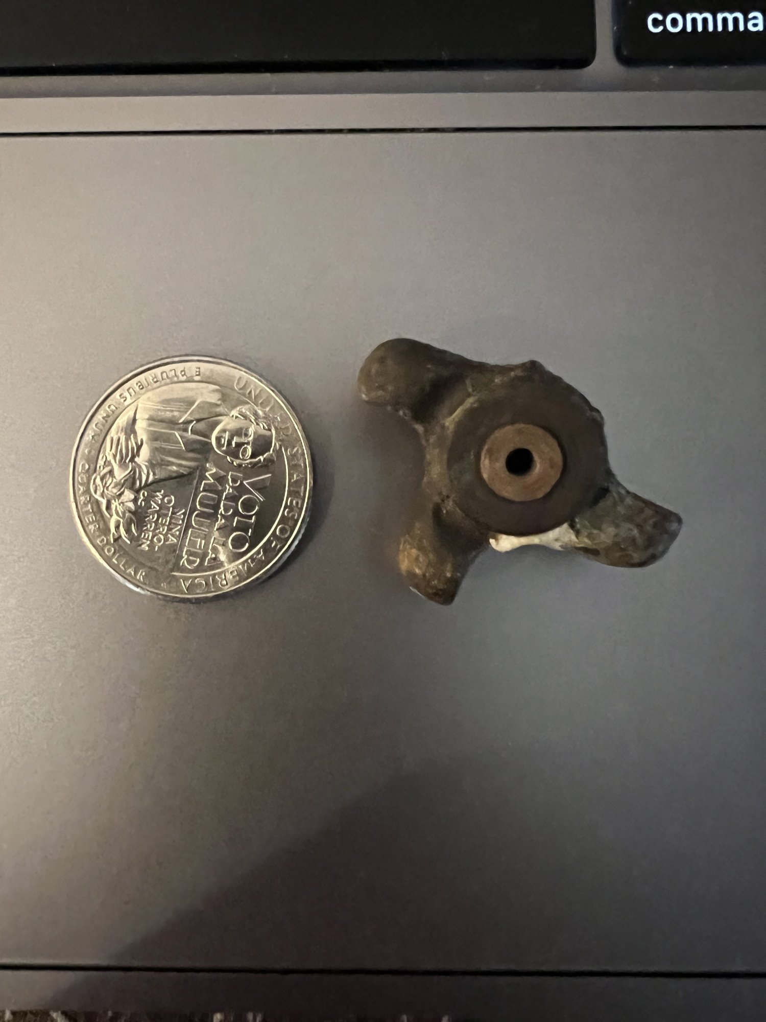

My knot meter impeller is broken and I'm looking to replace it. I have found images of the unit, however the included o rings in the replacement kits look to be all different sizes. I was hoping to narrow it down.

That’s a different impeller design than we had on the Data Marine instruments. That’s more like the shape of our current Airmar transducer.
That’s the paddlewheel of a speed log transducer. If you pulled out the transducer and inserted in the blank, measure the diameter of the transducer and the wheel then web search for a matching paddlewheel. I don’t think there are many sizes. Looks about the same as mine, which is Airmar, etc.

I had already thought about what Kings Gambit suggested, however that kind of search doesn't work. The search results I was able to get show many styles, however no OD or ID measurements given, nor the O ring size listed. Next time I'm in Annapolis I'll go to Bacon and see what they have. Thanks to those that responded.

So I bought a kit that showed a similar knot transducer. However as suspected, the paddle is identical, but the O rings way too large.
63
Oday 30 Stamford CT
I purchased my 1983 30' O'day new in Jan 1984 and instruments were not an option from the factory. I purchased my Data marine knot and depth meters from my O'Day dealer who installed them. Knotmeters and depth finders similar in appearance to the original Data Marine units as well as parts and repairs are available from DMI Marine in Middleborough, MA.
