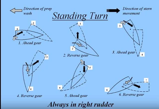

Sorry for not elaborating. By "standing turn", I am talking about the technique, where, when stopped, switching between forward and reverse throttle to effect a 360 deg turn without significant forward travel. This is done with the full right rudder. When doing this, going to reverse, the stern movement is inconsistent: sometimes the stern will move to port as expected, sometimes to starboard and sometimes not at all - during the same turning maneuver. (Believe me, I know this sounds crazy as I type this, the physics just seem wrong to me.). If I can get the boat to start to back down, it seems to pull to starboard, but then if I ease right rudder, it immediately swings the stern to port. The behavior is strange enough that I've even questioned whether I have a left-hand prop. I admittedly don't have tons of motoring experience but I have never experienced a boat that seems to behave as strangely as my S2. I was just curious what others have experienced to decide if it is:

The way I have always done a "standing turn" is with some forward motion. Also it takes bursts of power-1500 to 2000 rpm to pull and push the stern over.

You should be using 30-40 degree right rudder, not full right rudder. Figure out what that is on your wheel (or rudder indicator) and make a note. Putting a ring of colored tape on your wheel helps as the chaos of close-quarters docking consumes your attentions.

I think the standing turn only works well in one direction because you have to take advantage of prop walk in reverse
Absolutely, good point, Scott.
Do them so you're set up to move the stern to port first (on MOST boats). Since prop walk only works when the boat isn't moving fore or aft, you want to use it when the boat is stopped to start the turn.
