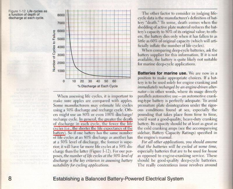

Battery Life Cycle Chart / US Battery (LINK)
Those "life cycles" are "lab" life cycles where the batteries were charged and discharged at controlled temps, charged immediately after discharge and basically not tested in the real world. The claim of 500 cycles to 0% will simply not work in the real world..
The industry definition of "deep cycle" is to 80% depth yet most battery manufacturers don't recommend this and recommend 50% instead because your batteries will last longer if cycled less deeply.
Can you go to 80%? Yes, and people do but the batts just don't last as long. Numerous times I have helped people extend battery life by simply adding a battery monitor so they know what is actually going on with their system. Most were unknowingly going to 80% or more deep and after the monitor to only 50% DOD. The life of the batteries, with all else being equal, usually goes from about 2 -2.5 years on average, with these customers, to 5 years+.
