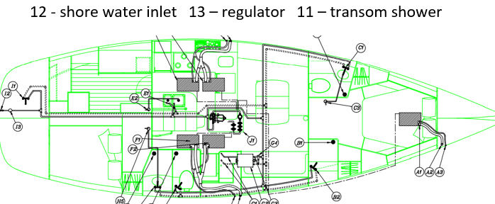

I just picked up a 2007 H38.
The manual says the dockside water supply is plumbed in after the shipboard water pump and pressurizes the fresh water system, and that the pump acts as a check valve. There is no mention of any valves that need to be opened or closed or any other action.
When I connect the dockside water supply only the shower on the transom works, no water anywhere else unless I turn on the fresh water pump. That leads me to believe the water exiting the faucets is coming from the tank not the dockside.
Additionally if I do not connect the dockside supply the shower on the transom does not work pump or no pump.
Its acting as though there is a valve somewhere in the water supply after the transom shower (which is teed in right to the dockside supply line).
Does anyone have any insight?

...........The manual says the dockside water supply is plumbed in after the shipboard water pump and pressurizes the fresh water system, and that the pump acts as a check valve. There is no mention of any valves that need to be opened or closed or any other action................
Congratulations on your new Hunter 38!!
My Hunter 46 shore water supply connects to the potable water system in the same manner as your manual describes and as shown in the schematic diagram below without any valves. Suggest reviewing your owner's manual potable water schematic diagram then trace the circuit from the shore water connection to downstream of the pump to confirm the plumbing line-up. Once you get it operational, you will find it really convenient. Please let us know what you discovered.

Yes I've reviewed the manual and schematic and it appears it should "just work". I've dug into the stern locker from the stern and also from behind the aft cabin bunk and, while I can't get eyes on all the plumbing, I don't see any extra valves.
There's nothing to do at the actual fitting is there? No plug or Allen key or anything? I'm assuming not as water is actually making it to the transom shower.

Nothing to do at the actual fittings, no plugs and no allen key required to turn anything. Might look at the shore water line connection downstream of the pump.

Ok got it fixed. Thanks everyone.
on the manifold under the galley sink even though “water inlet” was on, “transom shower” was in the off position. Turning that valve to on solved the problem. I’m not sure why yet, need to retrace the lines, it possibly a prior owner or even the factory has the two lines backwards or maybe just and idiosyncrasy of the setup.

Sounds to me like they have the transom shower and the shore water supply tied together and are using the same line to feed the water manifold under the sink when the shore supply is attached.
