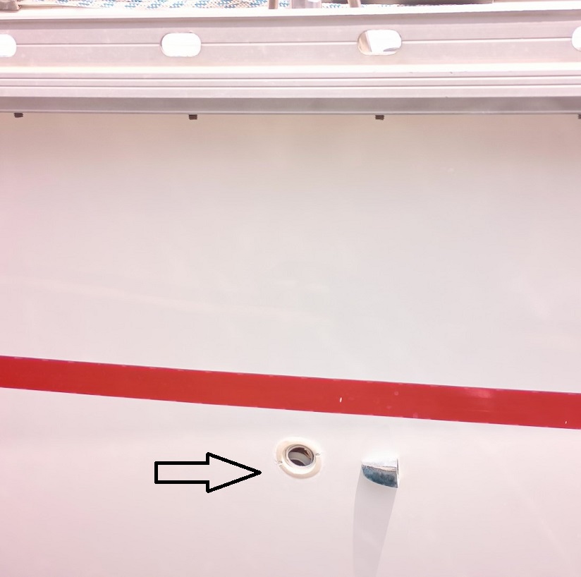

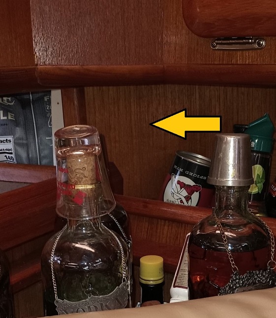

My 1994 40.5 broke a through hull. It's the bilge discharge. It appears the access is behind the angled panel below the port salon aft cabinet at the corner with the galley cabinetry to the side of the liquor bottle storage.
My question is if any of you have gone in there for any reason? I can't think of any other place it would be but I would like to shake the hive to see if someone else has accessed that.
Needless to say, I will be installing a S/S fitting...:cool:

Maybe you can get to it by removing the seat plywood and then going up behind the panel? That would be my first attempt.

The thru hull is actually behind an angled panel inside of the wooden cabinet that is in the upper portion of your picture. Open the door, remove the screws holding the panel inside the compartment and you'll see the bilge discharge thru hull. Now to replace the hose, you may have to do some more disassembly since it is a tight fit to try and pull the hose with all the bends To access the hose you need to remove angled panel below the liquor rack and possibly other panel pieces too. However if it is just the thru hull it is inside the cabinet behind an angled panel at the aft end of the cabinet.
Great answer Dan. I have wondered about that access for years, although I have not needed it yet.
