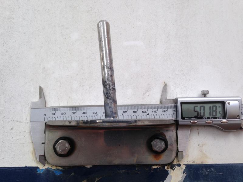

Looks like mine too - I can't measure it right now as it is in the yard and they lock the gates so we can't enter, and it's only open 2 days a week.
