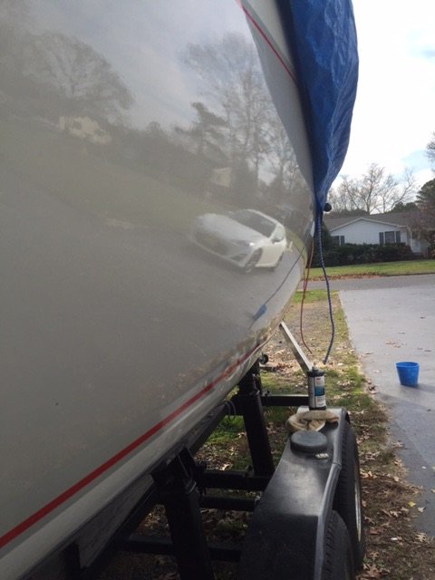

Every season I detail my hull. I hit it pretty aggressively. I use 3m heavy compound then a cleaner wax and collonite 925. I'm wondering if the hull is actually gel coated or painted. The boat is original. The reason I ask is that when I compound no gray color transfers onto my high speed wheel. I've detailed many colored hulls including an Oday with the traditional blue stripe. On other boats the color transfers onto the pad. It makes me think that the gray O's were painted and clear coated.

Sorry, my point is that heavy compound every year will wear through the gelcoat too soon. In that article, MaineSail discusses products that are progressively finer grit, removing the scratches left behind by the previous, heavier grit product. He also says only use the heaviest that you need. I started the first year with wet sanding and compound, then Presta Cutting Creme, but have not used the finest Presta Chroma with a foam pad. In subsequent years, I have only needed the Cutting Creme to bring up the shine, don't have to go as far as starting with compound, then Cutting Creme, etc. This coming year, I want to get some Chroma and a foam pad, and see how shiny it'll get...
And it's still gelcoat, not paint. It's just that they always did the creamy white color, then in later years make the newer design boats like 192, 240, etc in the grey.

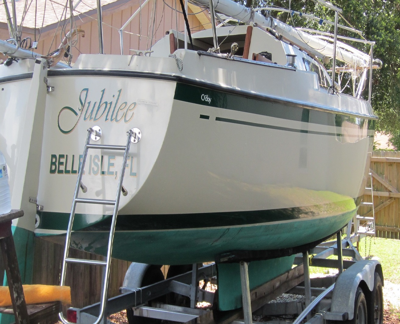

Coming back after the boat has been sanded, compounded and waxed with a cutting cream or polish the next year will give you a better shine. The cutting cream takes out small scratches the compound leaves, the polish... even smaller scratch removal. For a number of years I did the compound/wax and was very happy. A few years ago I went with HD compound, cutting cream, polish then wax and got a much better shine. Once this is done the first time, each year should just need a polish, wax. If you let it go too long it may even need some cutting cream first. The key is to stay on it, less aggressive is
best.
Likes: GregL564
