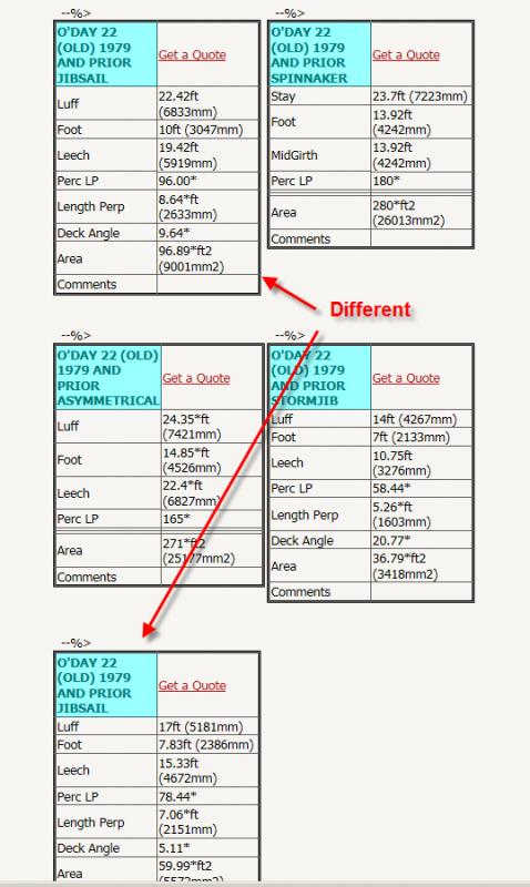

Oct 21, 2014
190
Oday 22 Richmond
Thanks for the explanation of the sail dimensions Joe and Scott. I am still having some trouble finding out what the actual dimensions were for the OEM jib. The chart that Ted referred me too is different then the other dimensions I have seen. I'm not saying it is wrong because I don't know at this point and I do thank you for sending me the reference Ted. Perhaps I am reading it wrong or one chart is for a fractional rig or something. I have included the chart to indicate where I am confused. One source I found indicates that the OEM sail was luff=20.18' leach=18.18' and foot is 9.1'. I understand from the explanation you guys provided that the clew is going to be higher depending on the cut of the sail as in the shorter the leach is (I) as opposed to the length of the luff, the higher the clew is going to be. The reason I am trying to go with the OEM size is that I would assume the original designer would have put some thought into this and come up with the best all around configuration. I got the OEM dimensions from a place called discountsails.net that represents a company called Rolly Tasker which is located in Thailand. They have some very reasonable prices but I'm not sure of the quality. Has anyone had any experience with them? They sell a new jib cheaper ($299.00) then I can buy a used one from Bacon sails. I'm going to drive up to Bacon sails on Friday to check out what they have and would like to have a good idea of what size to look for. None of the used sails are exactly the same as the OEM and the prices are all over the place. Thanks so much for your help guys.

Very strange ....
First things first because I find the data to be confusing. Sailrite indicates that you have a masthead rigged boat with "I" dimension of 24.0' Sailboatdata.com shows a 1972 fractional rigged boat with "I" dimension of 22.0'. There also seems to be a 1972 masthead rigged with a "tall mast". The 1973 model is masthead rigged with the dimensions referenced in Sailrite.
You should first verify which one is correct ... I tend to trust Sailboatdata, but I don't know the particulars for your boat. If you have any question, let us know. You may be finding a wide variety of used sails based on these differences. You will have to weed out the choices that don't apply.
Secondly, study the definitions of the P, E, I, J dimensions. They are your rig dimensions, not the sail dimensions, particularly for the head sail. Sailboatdata indicates that your forestay length is 23.42' for fraction rig, 25.63' for masthead rig. This does relate to the luff of the jib or genoa. But remember that the luff of the sail will necessarily be slightly less to accommodate fittings, furlers, etc.
You will find used sails of various luff lengths that will work (all shorter than your forestay length). If you choose a new sail, the manufacturer should have your dimensions to make the luff according to your requirements.
I would not worry too much about the OEM specs for the original sails. If you buy a new sail, the important thing is to have it made to the specifications that you desire. If they have pre-cut sails and all you are doing is specifying the overlap percentage (like 110%, which is typical for an OEM sail), you should be fine as long as you verify the rig dimensions. I'd hate to see a mistake based on the confusing issues that you are noticing.
Look on-line at Sailboatdata.com for your model of O'Day if you have any question about these issues. Plus, there are plenty of O'Day owners in the O'Day forum that should be able to clarify.

Thanks Scott. Yes Ron I did check with Bacon and they have quite a few that are supposed to fit an Oday 22. They are all different and that is why I am confused.

Scott's explanation should be really helpful to you....
Throw those charts away that you posted earlier and use your own data. PERIOD. Do your own measuring..... presto! no more confusion.
Go to this site and follow their instructions... http://thesailwarehouse.com/cgi-bin/web_store.cgi?page=storeframe.html&cart_id=
Oday 22 masthead rig... Standard OEM type jib 110% Luff 22.8 Leech 20 LP 9.35 5 oz Dacron OEM quality (lowest) with hanks price is $335
a 150, same quality, will run you $475. Luff 24.25 Leech 23.00 LP 13.50 Cloth weight 4.00 Hanks
Is it clear that the smaller sail has a shorter luff, allowing it to be hoisted a foot or more off the deck for visibility(using a tack pendant), or tacked at deck level and not fully hoisted.... your choice. The 110 working jib has heavier cloth than the lighter weight 150 genoa which is for lighter air.
