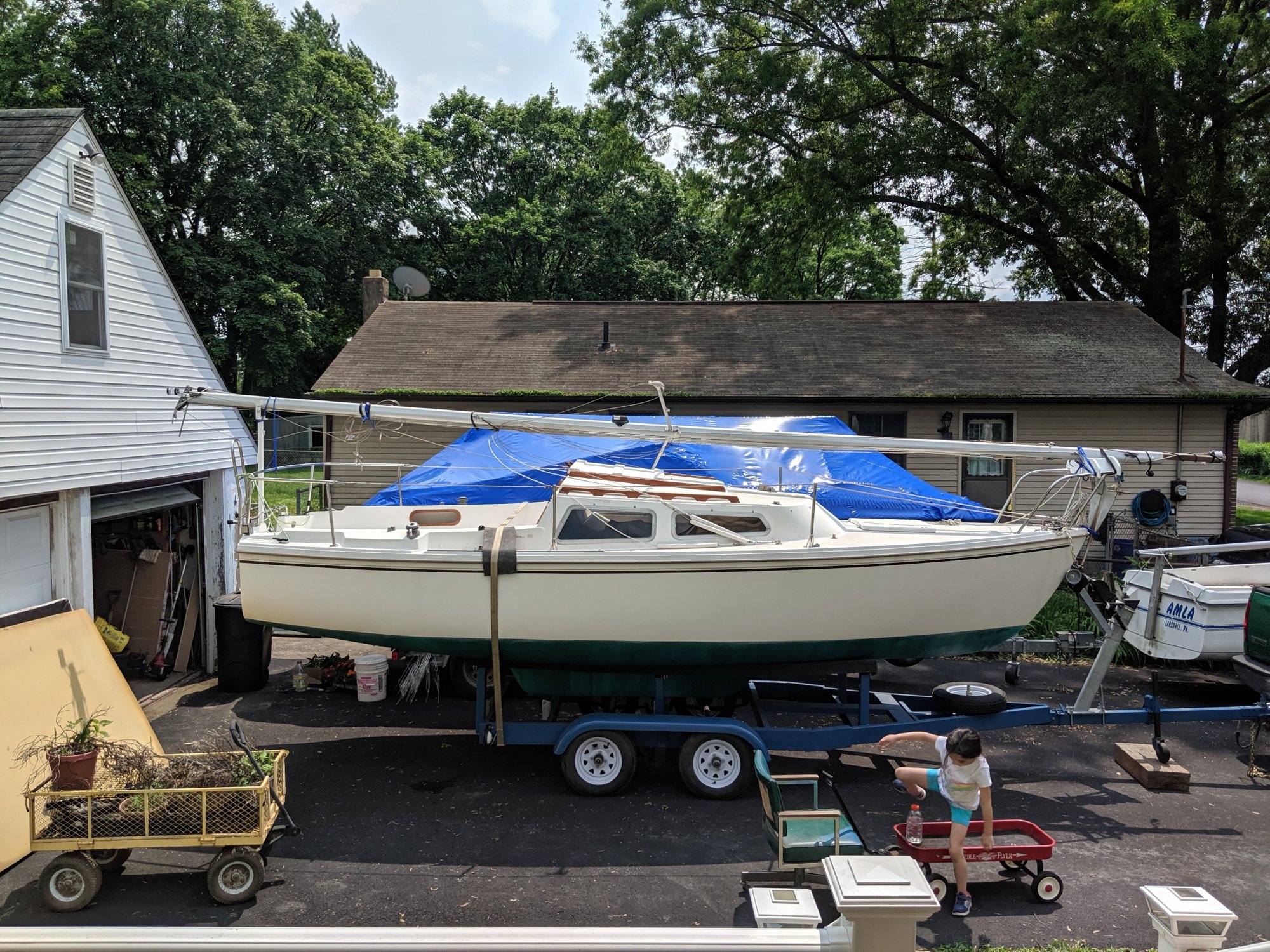

I have a Catalina 22 with CDI furling jib and I'm wondering if it a pain to rig every time I trailer? my trusty Newport 17 can be together in about 15 minutes by myself... the 22 had a bit more rigging and I'm wondering if it'll be too much work to rig and launch for just a day sail.

my boat has the CDI flexible furler.
no snow up there now, but it's still 3 hours away and my wife and I opened a cafe here in our home town about a year ago so we've been pretty busy with that. I'm hoping to free up more time for sailing this spring.
my boat has the "roller crutch" to lift the mast after it's been pinned, from what I've seen on YouTube I should be able to raise the mast with the main sheet and this "crutch". The thing that has me "nervous" is that I'm not sure if the shrouds are at least close to what they need to be.
Will the mast stand with no tension on the back stay?

On level ground (boat level) light wind, the mast with forward lower (2) and aft lower (2) shrouds attached will stand without any other shroud or stay attached. Think triangulation. Aft lower (2) shrouds and forestay will hold the mast up. Upper shrouds (2), forestay and backstay work. Just don't go sailing without all shrouds and stays attached.

thank you, I was just worried it wouldn't stand long enough for me to get the forestay and back stay attached. I'm coming from a very simple rig on my Newport 17, just 2 shrouds and a forestay.
my backstay has an interesting arrangement... I wish I had a picture of it. it is split with two metal rings which I think are for tensioning it. I also have a CDI furler which I didn't have on the Newport... for me this boat is a big step up.
