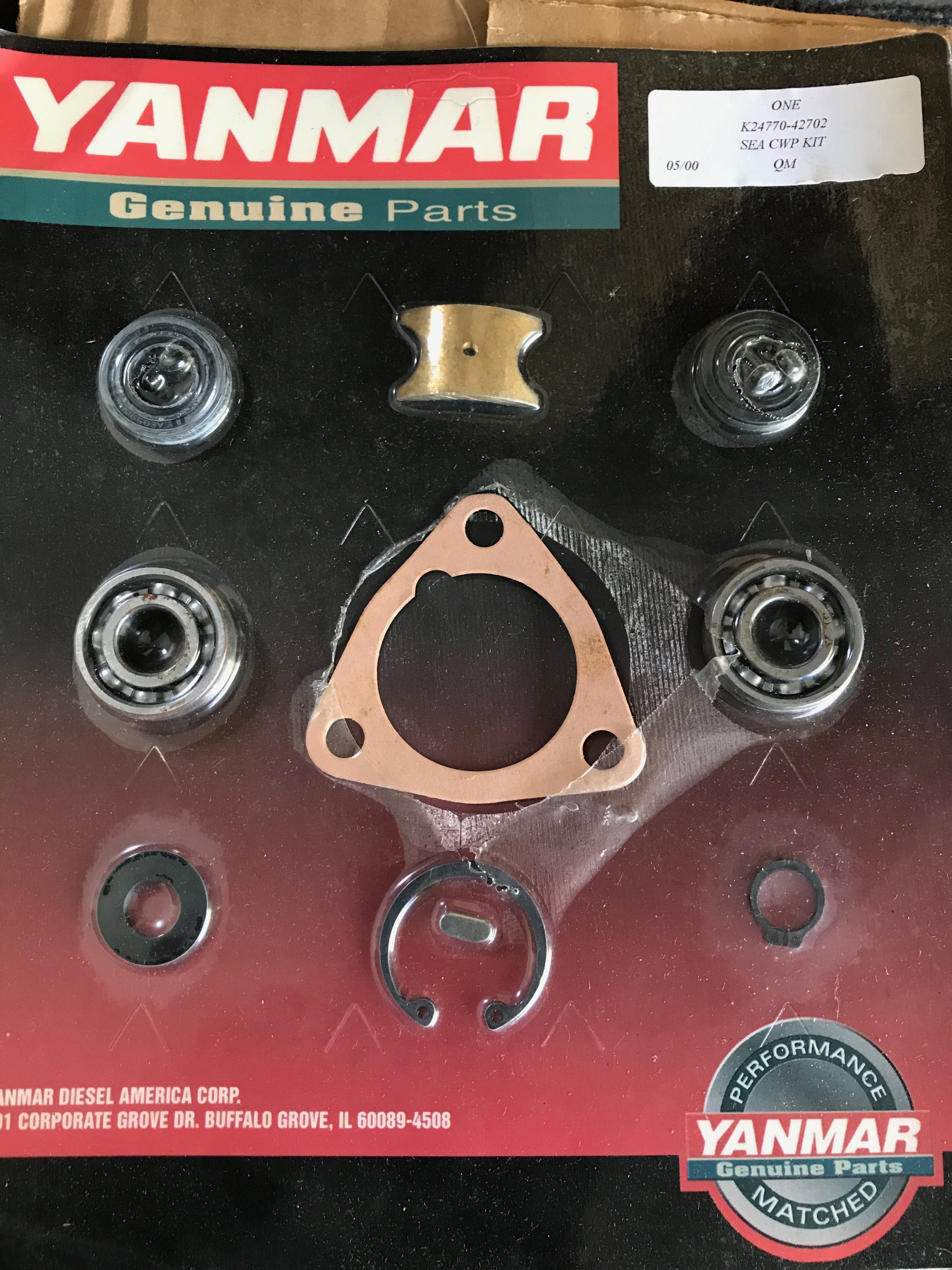

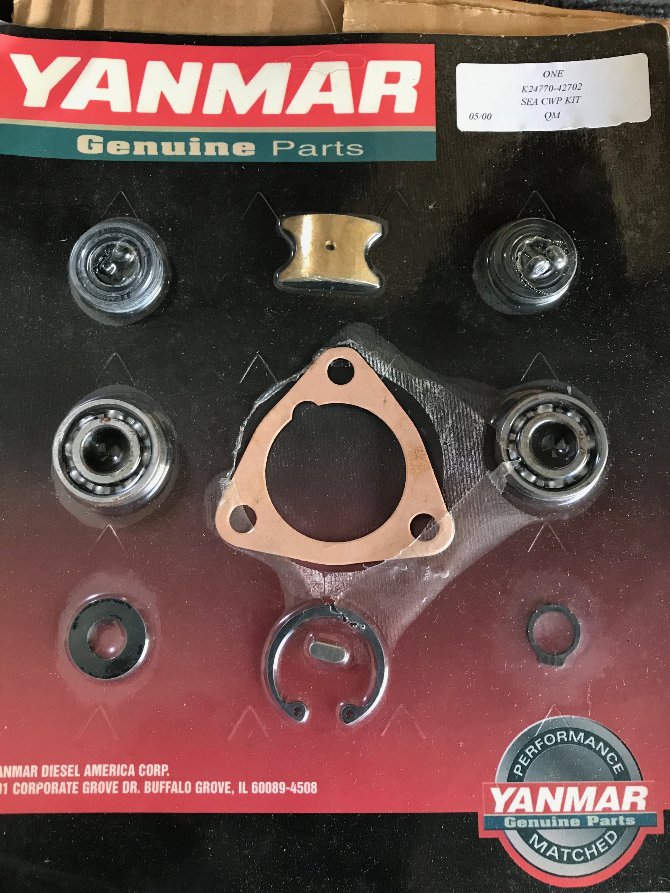

So.... the plot thickens! Going through boxes of new and old parts from the previous owner, there is a set of replacement parts for a water pump. I'm attaching a photo. I'm not sure if these are parts for the belt-driven pump I'm operating on, or for the engine mounted pump that circulates glycol.
Anyone recognize the kit from these photos?
thanks!
Tom

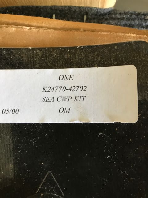

Your second pic shows a label that, I think, translates as follows:
K24770-42702 : Part Number of the Kit
"SEA": As in 'sea water'
"CWP": Centrifugal Water Pump
05/00 : Kit put together May 2000
This is a SWAG translation. But to me would indicate it's for the raw water pump.
thanks!
Tom
Most Def the pump that is integral to the front of the engine. Originally designed to push seawater in our "H" series engines, it's duty was revised to do the anti-freeze. Discussed in this thread only about a month ago. See Post#6 for some breakdown pics contributed by member Alctel. Lucky you to have the rebuild kit on hand!

That is definitely the raw water pump. The fresh water pump is not rebuild-able if it is like most.

Thanks everyone for helping sort out this mystery! Looks like I'm well-prepared if the glycol pump starts leaking, but it's time to shop for parts (or replacement) for the 2760.

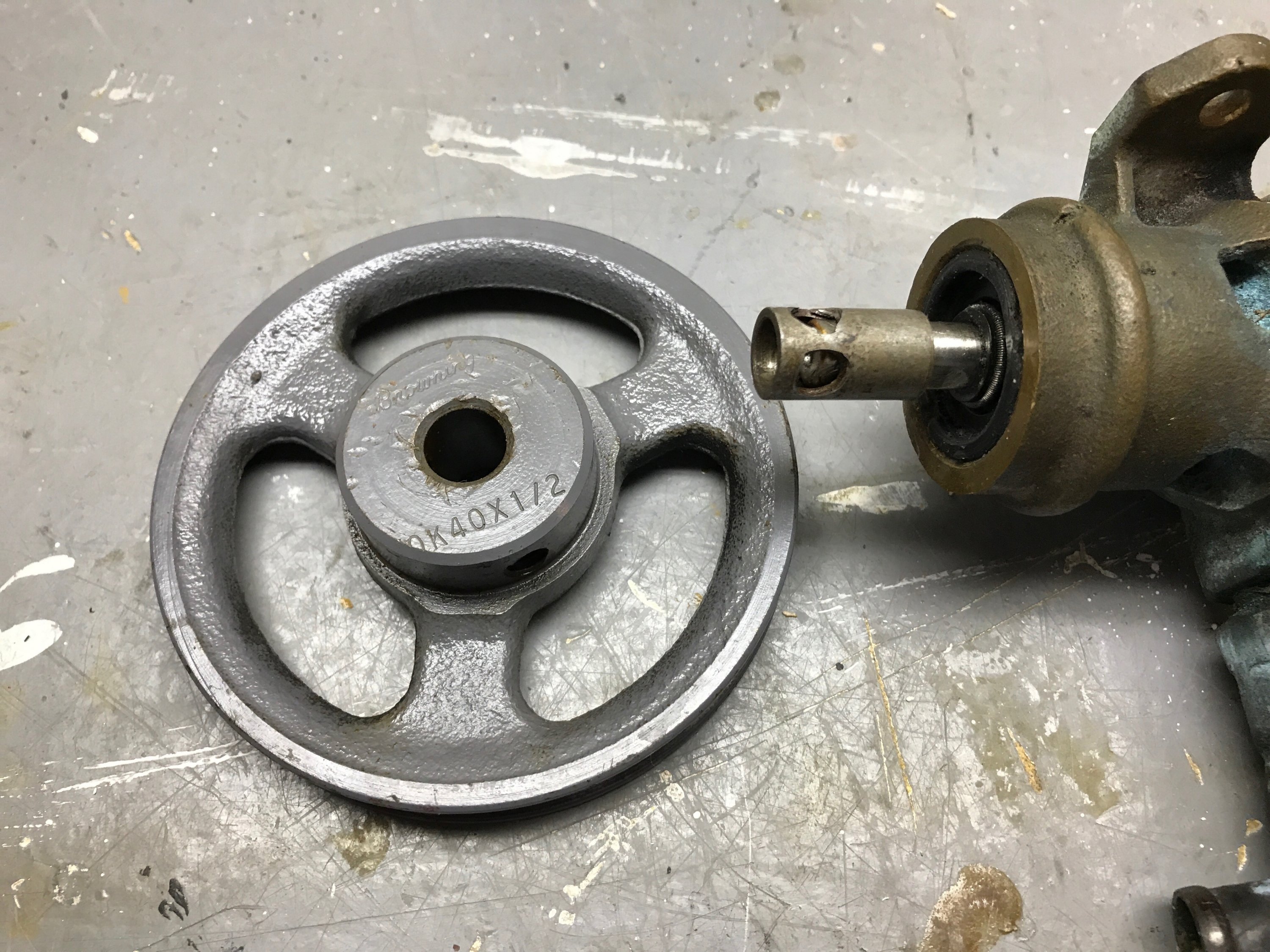

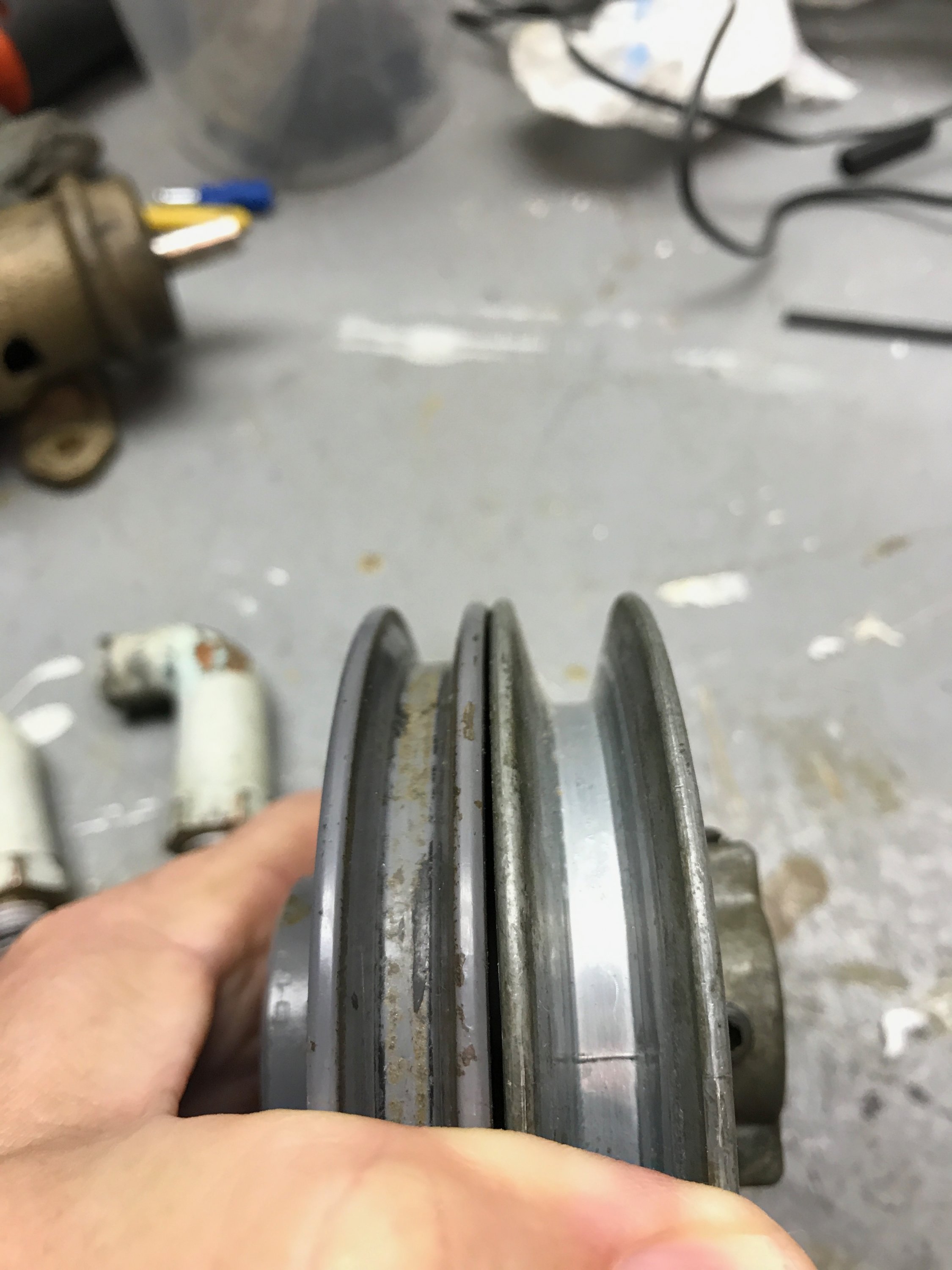

Hello all, it's me again, the water pump guy.

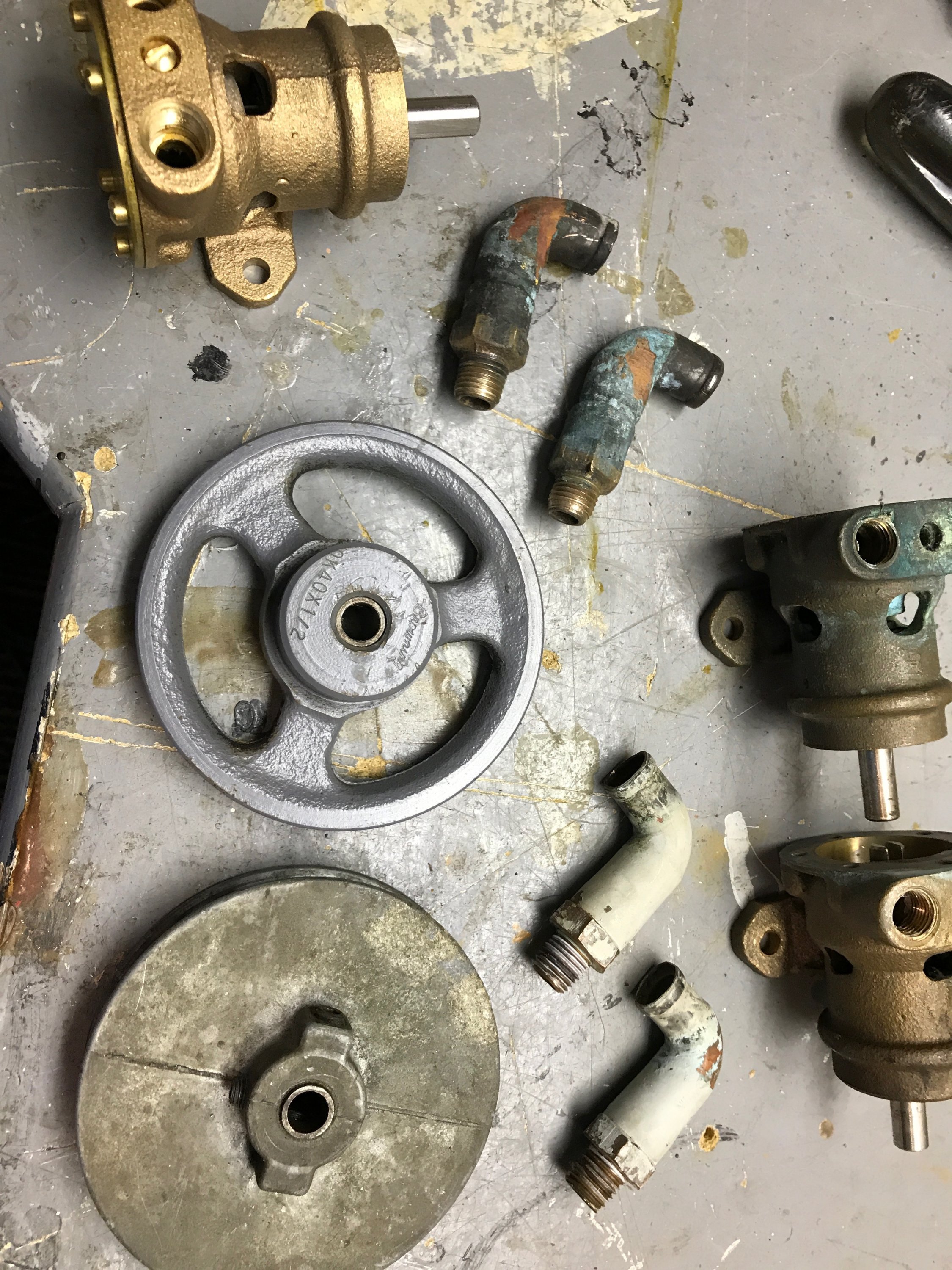

Since my last post, I ended up buying a new raw water pump (via eBay). Then I found ANOTHER spare (used) pump among the boxes of stuff from the previous owner. However it was completely frozen up, so that's a project for another time. I'm accumulating quite a collection of water pumps, it seems.IMG_3848.jpg

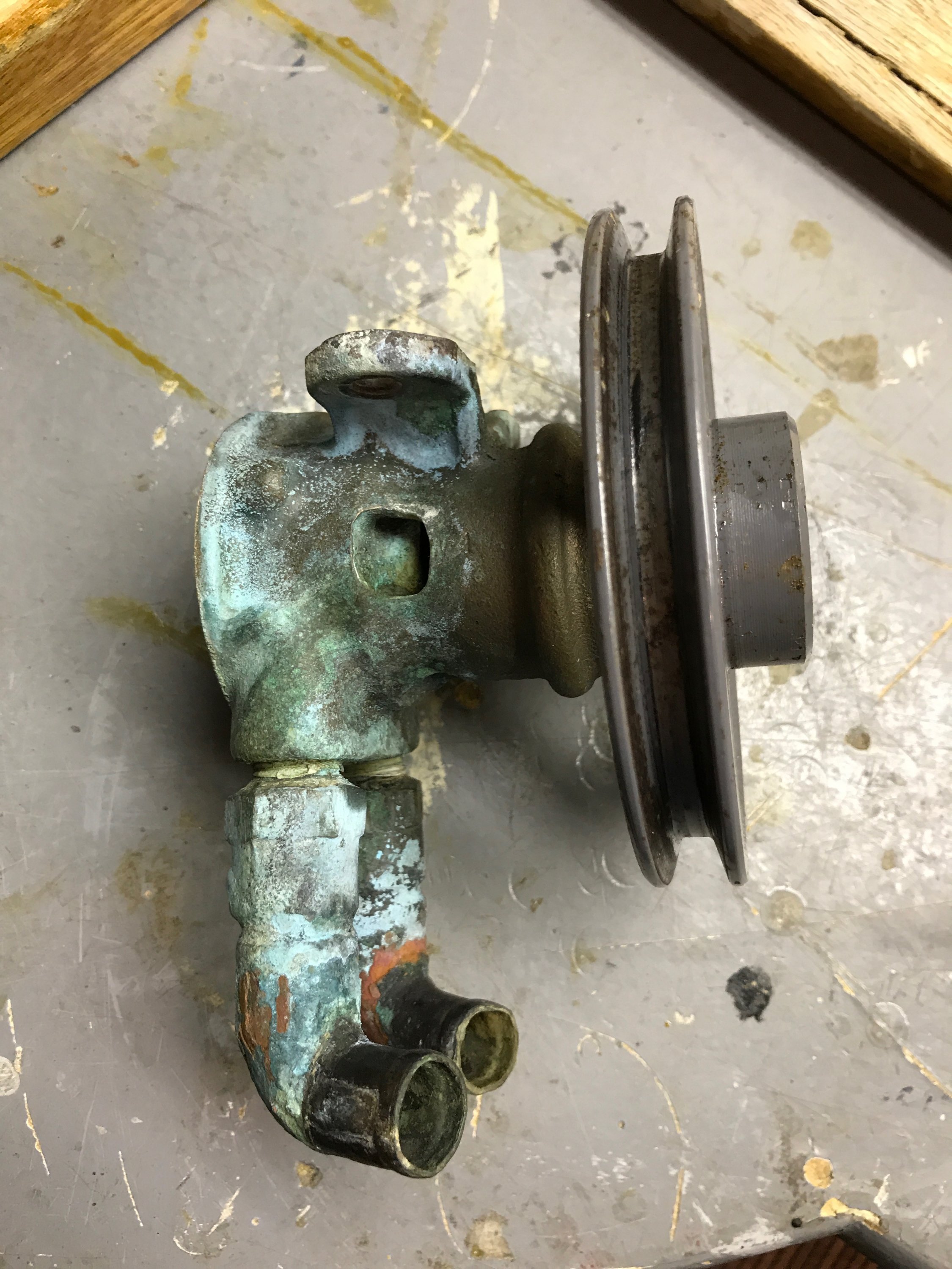

Anyway, I noticed that the pulleys were different on this recently-discovered pump and the one in use on the engine. Any ideas why that would be? I'll probably use the gray painted one (on left) since that's what was most recently in use. IMG_3851.jpg

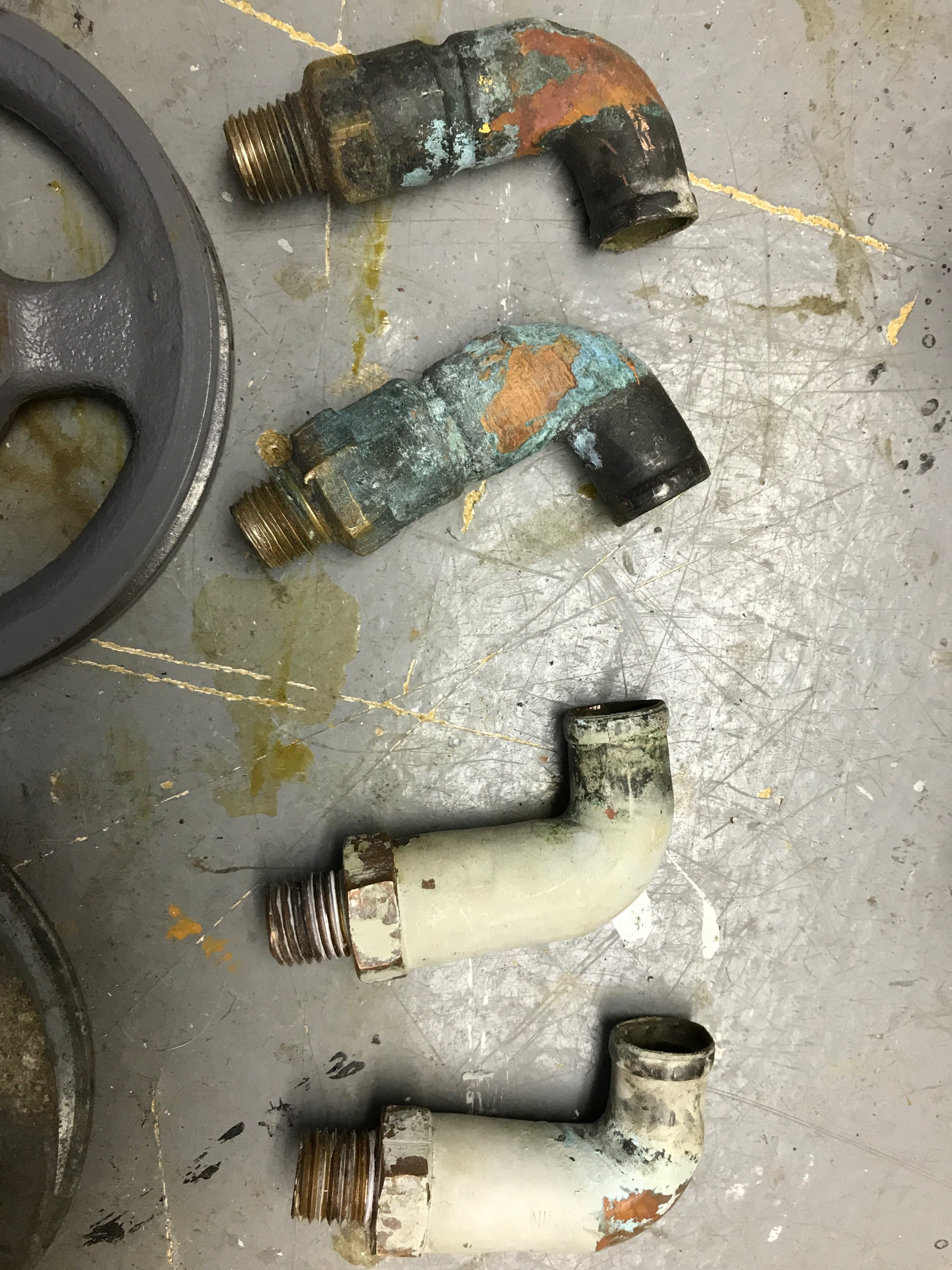

Finally, the two L-shaped adapters (from the pump inlet/outlet to the hoses) are in rough shape. They appear to be made from possibly common copper plumbing parts. Anyone try making replacements? Or can they be purchased?IMG_3850.jpg

1/ picture looks like old and new style pulleys which will each possibly require its own unique belt. 2/ the l shaped inlet and outlet adapters are threaded so the male threads have to be the right pitch to fit the female pump body. don't know if you can get the right threads buying these elbows off the shelf at home depot etc. 3/ for the part number shown on the pump part you have, find it in the yan parts manual for your engine and it will tell how those part all re assemble. boat diesel.com has some diagrams you can search but you may have to pay a nominal fee to view service manuals and post questions. boat diesel.com is a great bargain if you do much mechanical work on your engine......

as for the picture of the pulleys the out side one you can see is to wide and running on the center of the pulley. which would not make proper contact to belt as for the fitting some hardware stores have stainless fittings not at home depot just get a nipple and a 90 deg, and add a hose barb.

Thanks everyone for your help and suggestions! We are up and running with no leaks.
I will look for parts to make replacement fittings for those L shaped adapters. The copper felt kinda weak and is pretty corroded so I doubt there is much life left in them. If I come up with something novel I'll post here!
