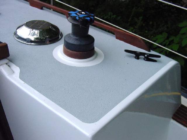

final report
I finished painting on Friday(10/3/03), and I came to a few conclusions:1) You cannot put too much sand in the paint. I began by following the instructions on the can (mix one can sand with one gallon of paint), but I steadily increased the amout of sand as I went(I would say that I ended up using about twice the ratio I started with), and I like the final mixture much better than the original mixture.2) My method for masking curves was to lay down a piece of tape, use a pencil to draw the outline of the curve, then move the tape to a plastic cutting board and cut along the line. I had far less paint bleed than I thought I would with this method. There are a few places, but I think I can clean it up without any major issues.3) Cooler temperatures greatly slow the drying time of the paint. It has been 70's during the day, and low 60's at night, and even after 3 days you can tell that the paint is soft and is still curing.4) A 4 inch roller is your best friend when painting nonskid. I found that a 4 inch roller would let me get into most small areas and was still very fast, and put down much more paint than a brush. I was worried that the grit wouldn't come through, but that was not a problem at all. I also used a brush and a 9 inch roller, but I found that with proper masking, you almost don't need the brush, and the 9 inch roller is too big to get into most places.Thanks for all your help!
