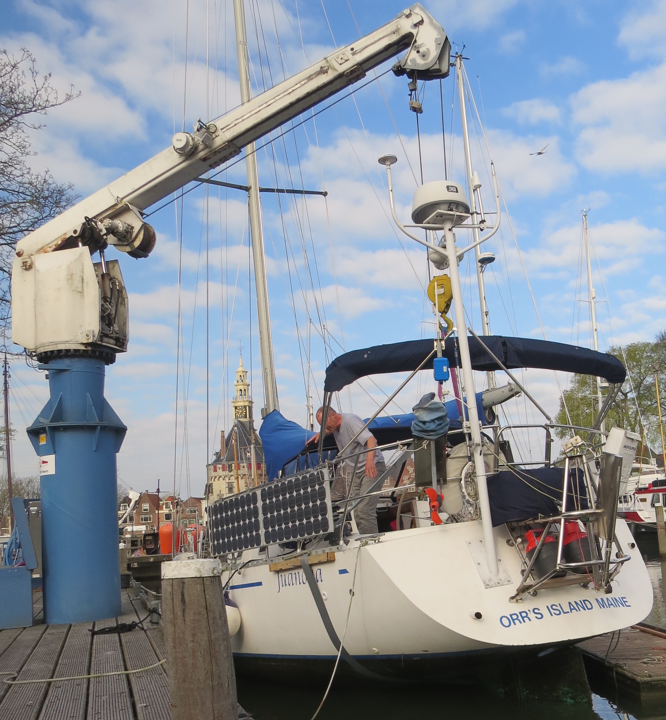

Thanks guys, a lot of interesting ideas. I'm scheduled to have a dock crane (what you see pulling boats like Solings out of the water) lift my stern on Friday. I'll post a pic. They say they've done it before.

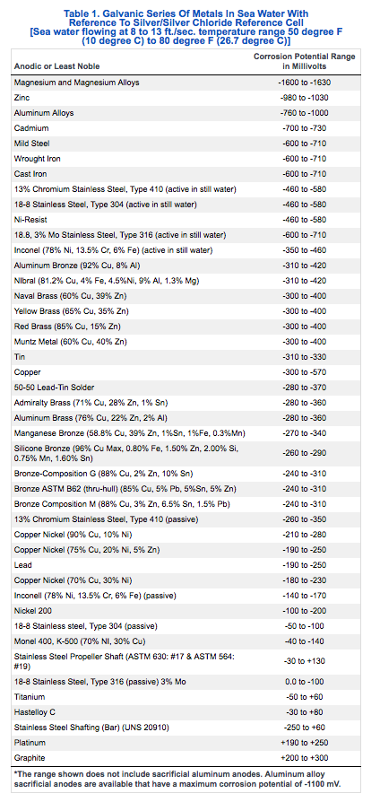

Zincs last longer in freshwater because they don't work in freshwater
Zinc will protect Aluminum if the water conducts electricity. Nothing protects in "Lake Distilled Waters" either.
Please note the chemistry. Zinc is more reactive than Aluminum. Fresh water or not. Only the voltage potential changes in less salty water, but the Zinc protection is for any metal lower in this list than Zinc. Not good on magnesium boats.

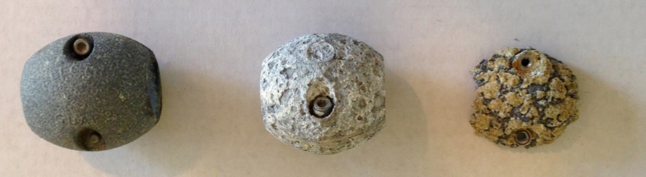

From left to right, zinc anode, aluminum anode, and magnesium anode. All from the same boat in fresh water (Lake Ontario). The zinc anode was on the boat for many years, the aluminum for one year and the magnesium for 2 years.

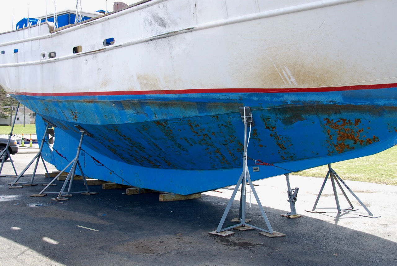

This is what happens to a steel boat in freshwater with zinc anodes. The other issue is that there are an inadequate number of anodes.

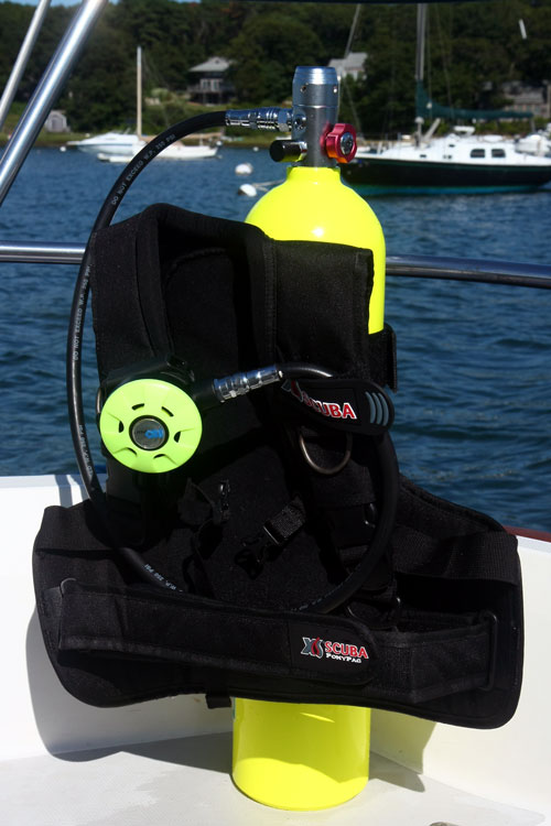

Mantus (the anchor people) make a perfect SCUBA set up for us sailors. It is relatively inexpensive and only has a 20 minute capacity, but for replacing anodes and quick bottom cleanings it is perfect. However, it is necessary to get he full SCUBA certifications. Alternatively, a floating hookah system would enable a skipper to stay underwater long enough to do the same.
I built my own simple system a few years ago.
Didn't cost that much.

The lift didn't quite work today. After they lifted the stern clear of the water, the crane started to slip - the boat was just a bit too heavy for it. Thankfully I wasn't lying on the wooden raft under the boat. It goes to show how a seemingly simple operation could kill you. If I'd been lying on the raft when the boat came down, it would have been potentially fatal.
Thanks in part to some of the feedback here, I found a dive shop in Amsterdam that will rent me a tank for a day or two. I will plan to do that when I return from a trip back to Maine. My mom is in her last days.
Thanks for all the feedback here, and glad to see the board still continuing.
PS notice the old tower of Hoorn in the background. Many of the East Indies expeditions sailed from this harbor, as well as the expedition that discovered and named Cape Horn.
