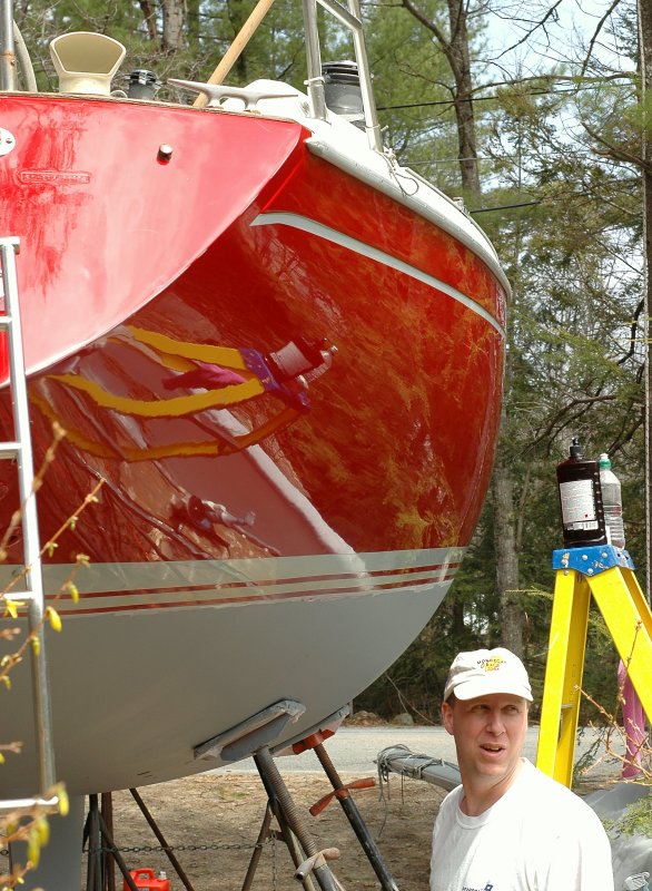

Tim R's Ericson (below) has a fire engine red Imron finish, the most fade prone color, and it's approaching the 19-20 year mark. I think the picture says it all. .015 mills of a colored gelcoat will be wearing quite thin by the 19-20 year mark as it will require more "attention" than the white.
You'll also spend far more time maintaining, compounding, polishing and waxing a gelcoat finish than you will with a cove and boot paint every 10+ years maybe 19 or 20. Another consideration is that colors other than white or off white in gelcoat have substantially shorter life spans. Green, red, navy, royal blue will all fade significantly faster than the white hull..
19-20 year old red Imron..
