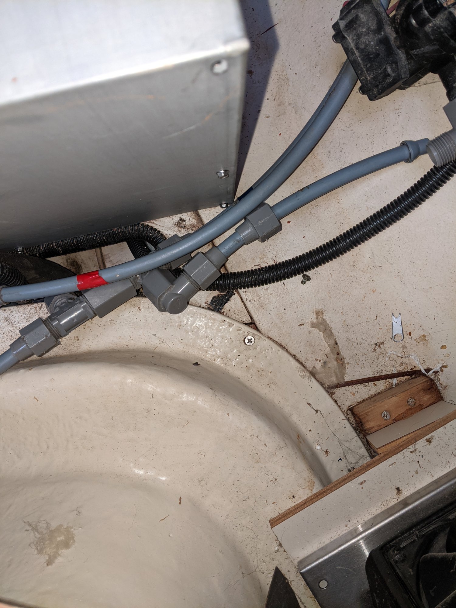

I'm getting ready to winterize our 1996 Hunter 376 for the first time. I'd like to add a water heater bypass, but am unsure as to the piping size to acquire the proper fittings.
I'm 99% sure that the piping is Quest (grey color, pex type fittings--see attached pic), but I'm unsure. I see lots of 1/2" connections available when I searched for Quest tubing/connections online, but I know Hunter sometimes used metric connections as well, so I'm not sure if that's the proper size.

I hope someone knows. I don't. It's very hard to tell a size from a photo. And even if you show a coin for sizing, it's usually the inside diameter that counts. And that depends on wall thickness.

Just measured a Qest fitting and it's 1/2" ID. The factory installation tubing (1999) was PEX with 1/2" OD and 3/8" ID.
Have not seen any metric Qest fittings so you're safe with 1/2" fittings.

Awesome. Thank you! Fittings are on their way...and, now that I see it's spelled "Qest" I see that this topic has been covered before...thanks for the info and sorry for the redundancy!

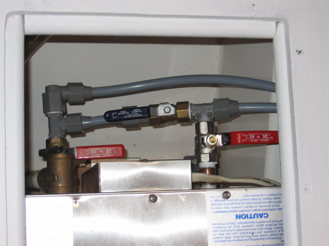

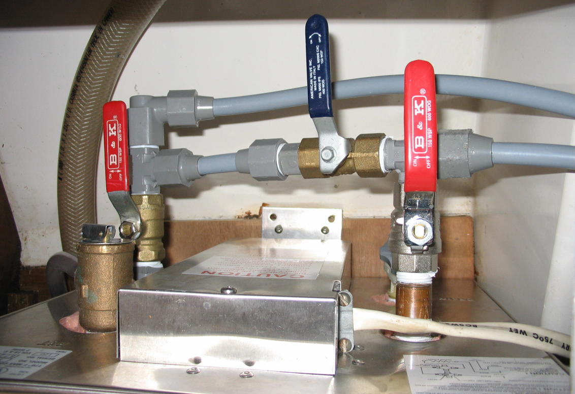

FYI here is how I did install the bypass on my water heater with the same Qest fitting as yours. In the Winter position the tank cold water inlet and hot water outlet are shut off and the bypass is opened. Summer position is obviously reversed. Hope this helps.

@Claude L.-Auger -- Thanks for the pictures! This is similar to what I was imagining (looks like the set up in our RV)--it's great to see what it looks like outside of my imagination.
