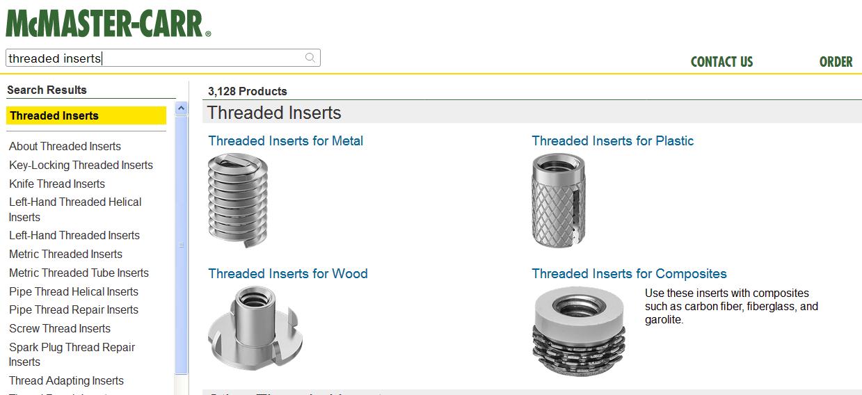

Given the cost of the handrails and the importance of pulling them tight to the cabin top, I'm wondering if going with a threaded insert for a bolt is a good idea. Plus the recommendation on the byutl tape to tighten a bit at a time.
That way I can get the inserts placed on the workbench, rather than worrying about messing up a hole when working upside down...
Good idea or bad?
Don't see how this would be a fraction of the strength of a #10 screw screwed into the handrail.
The only way to do this is to experiment with scrap Starboard first if you've never used it before. You will be more than impressed with its strength at holding a #10 screw with the correct pilot hole. Without this, you risk ruining the rail(s) you have.
