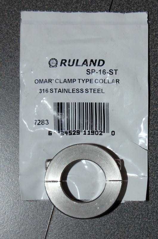

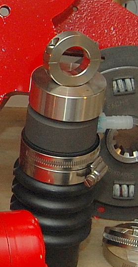

This is a 1" Ruland 316 stainless steel clamp collar. I install this right behind my rotor as added insurance. They are available from McMaster Carr and beat the pants off a hose clamp or shaft zinc....
Another view of the clamp collar.
When you only allow competent people to work on your boat, who will follow instructions, these seals are very, very reliable. I have had them on five boats and worked on boats pushing 4000+ hours on the original seals with no problems. The USCG even uses them..
Install them to the instructions and go one step beyond with a Ruland clamp collar and you'll have a long service life free of maintenance..

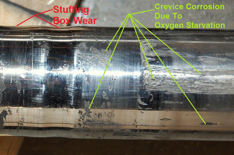

This is what can happen when you try to make a traditional stuffing box "drip free". You can potentially starve the shaft log of oxygen by 100% sealing at the seal. This can lead to crevice corrosion of the shaft and also shaft wear. This shaft was using the mouldable packing clay and is now seriously worn and ruined from fairly extensive crevice corrosion.
Traditional shaft seals need to drip for more than just lubrication it also allows fresh oxygenated water up into the shaft log so the stainless shafts don't suffer from crevice corrosion. PSS Seals have been vented/plumbed since about 2002/2003 which allows oxygen into the shaft log and can greatly reduces the chances of crevice corrosion..

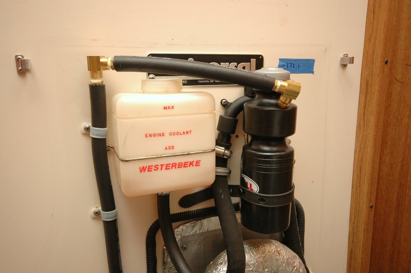

Nick

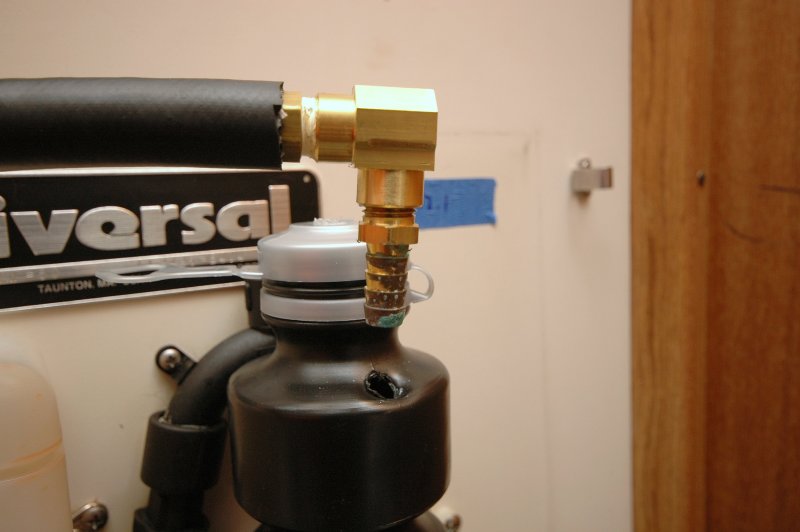

There are a number of ways to handle this. I only needed to drain this about once or twice per summer. Cheap & dirty but worked..
Here's one:
Another way is to buy a gas or diesel vent and plumb it into your cockpit so if it blasts back the water will vent into the cockpit.
If you vent it into the bilge you may create a potential boat sinking siphon at the worst, or at the very least not allow it to vent by creating a reverse trap..

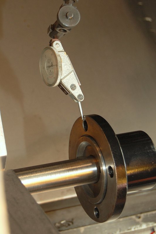

Hank,
What you describe is actually very typical of poor quality boat yard mechanics. When you remove a coupling that has a layer of rust between it and the shaft it should almost never be re-used. It is a very, very rare case that a one piece coupling that has been on for more than a season or so is re-usable. If it had rust, and was tough to get off, that layer of rust WAS your tolerance and the coupling is scrap iron. You'd be surprised at how many boat yard mechanics have no clue how a coupling is actually supposed to fit.
A shaft coupling should always be a light interference/press fit, many prop shops refer to it as an interference fit or light tap fit too. This means it often requires a lead, brass or phenolic hammer to tap it onto the shaft at a minimum. If it does not require some sort of press, tapping or force to get the coupling onto the shaft the fit and tolerance is not correct and will allow slight movements between coupling and shaft which will then work the key and set screws until a failure has ensued.
If you reinstall an old used coupling, and do not fit (to the shaft) and face it (out of round coupling face) you are only asking for trouble. As you found out the set screws will only work on a shaft with proper tolerances and they will not work on a loose or sloppy fit for very long. I am guessing the shaft was re-installed to the proper depth but that it simply slid into the coupling rather than required a light tap fit and this worked the set screws until failure.
I have been presenting the seriousness of this issue for a long on these forums and yours is a very good example of how not to remove and replace a prop shaft. While it can be done the shaft and coupling should always be taken in for a fit and face before re-installation. If this is done the prop shop would have picked up on a potentially loose fit and replaced the coupling.
You should make it a habit replace a solid one piece coupling once it has been removed and do a full fit and face. Couplings are cheap compared to a sunken boat.
Even with the new dimpling I would recommend that you replace that coupling the next time you haul out and have the new one properly fitted and faced to your shaft. Hamilton Marine will do mail order fit and facing through their shafting source at very reasonable rates.
Unfortunately this problem is not the fault of the PSS but it gets a bad name regardless...:doh:
