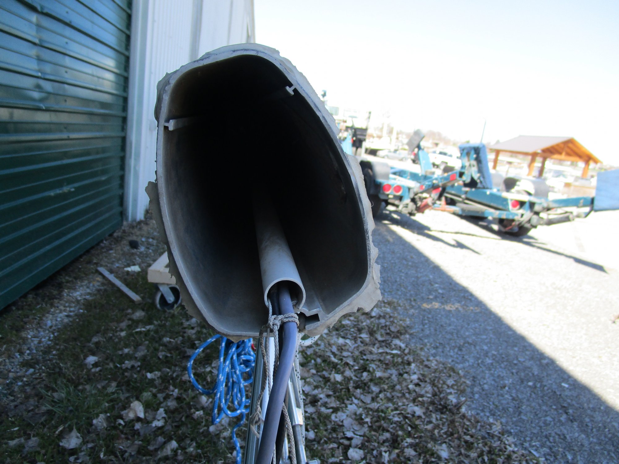

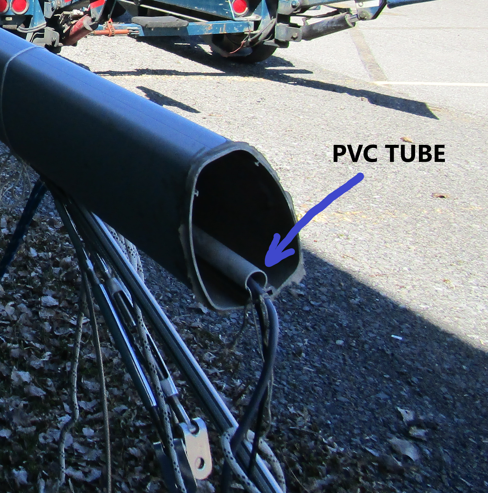

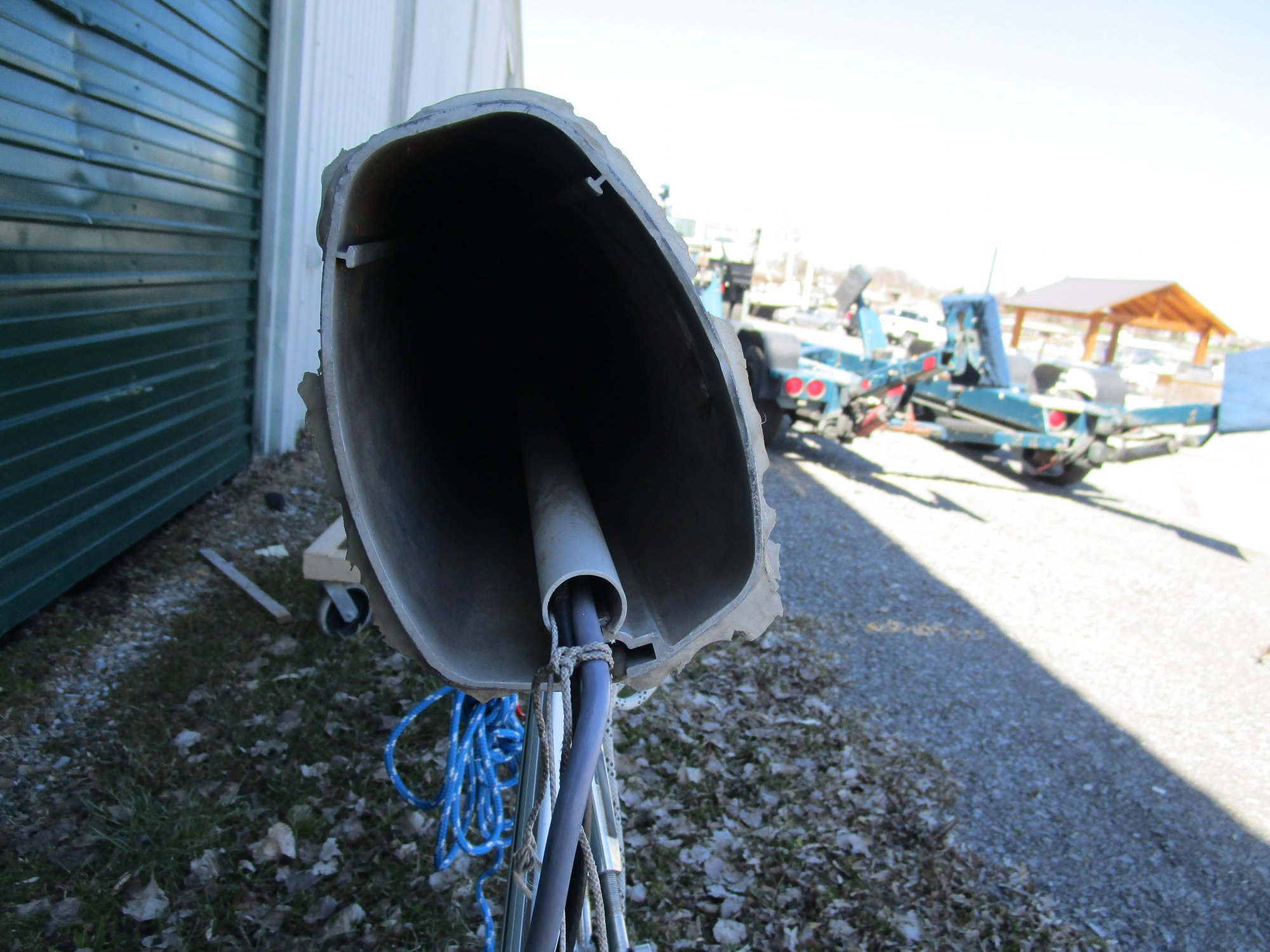

Can anyone confirm whether the PVC tube that houses the cables in the 340 mast runs up the entire mast? The mast is already stepped so I can't check it now. I'm having trouble with my main halyard binding and I'm wondering if it's somehow got wrapped around that tube. The previous owner replaced the halyard recently so I'm exploring all possibilities. The tube protrudes through the step plate and through the cabin top so I can see the bottom of it.

It is normal to install the tubes to run the length of the mast.
Do you have any electrical at the level of the spreaders? If so then you may have 2 pvc pipes one servicing the electrical at the spreaders.
It is possible that your halyard is somehow catching inside the mast. Some owners drill holes and insert screws in their mast. To long a screw can cause issues. But I would look at the more obvious places first.

In my experience the PVC pipe would be the least likely suspect. First it should be attached to the mast with a series of rivets. You should be able to see them on the back side of the mast. You do not need to do anything with the PVC pipe to pull a halyard.
Now if the PVC pipe is a new install, well that would be a different issue. It is possible to screw up the PVC pipe install if you have not done one before.

I suspect you may be right about the sheave. Is there enough space at the sheave for the halyard to jump out? I'm going to bring my drone down to the boat and see what I can see up at the top. I'm also going to look through the exit boxes to see if that reveals anything. The PVC tube does not seem to be attached to the mast because it will slide up and down inside the mast and I can push it up from inside the cabin where it goes through the deck plate. I'm speculating that it is just loose inside the mast with only the friction of the electrical wires keeping it from falling out completely when vertical. Attached is picture of the tube just resting on the track side of the mast (definitely not secured to back side).
24,949
OK then the installer missed an important step. You want to secure the pvc so there is no banging in the mast. The easiest technique is to use pop rivets. They just keep the pvc in place and out of the way.
