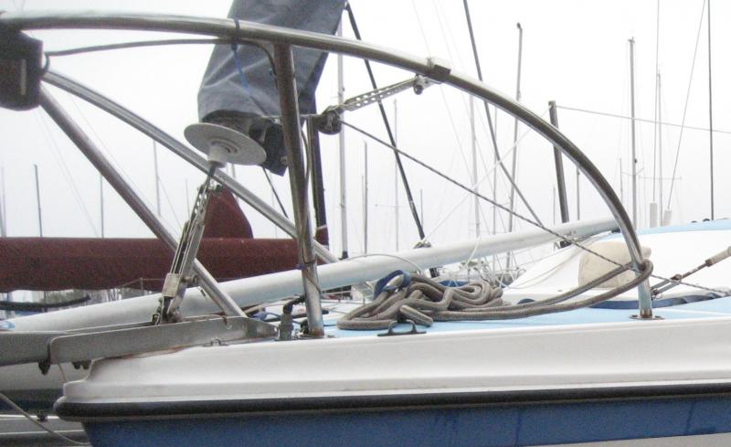

I had a block attached to the pulpit with an extention. You can make an extention using ss bar. I used this because it was onboard in my junk box. It is attached with a ss split rail clamp I picked up at Ebay.

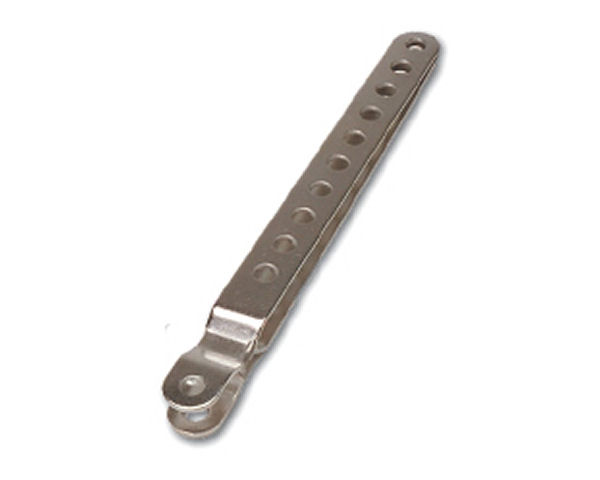

If you try to buy the "this" that caguy is referring too, it is called a shroud adjuster. Google it and you will find plenty of venders.
He should have a couple on board himself. Mine came from the spit back-stays when I consolidated them to a single back stay and attached the single stay to the sternrail with an ajustable block and tackle that attached to a split rail clamp (Another brilliant mod to the Mac 25, if I do say so myself).
