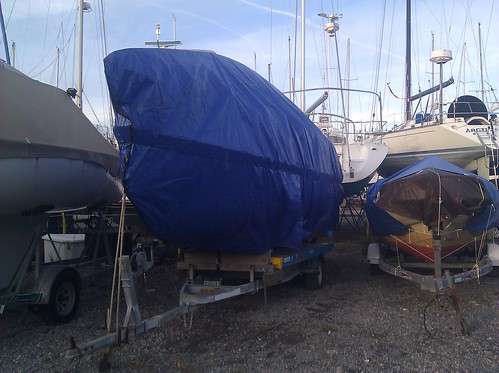

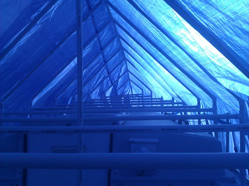

I've been using 1" PVC for years. It's quick, cheap and easy to work with. The 1" allows for easy bending and is surprisingly strong. The boom and spinnaker poles make excellent ridge poles. Here's a pic from the inside.

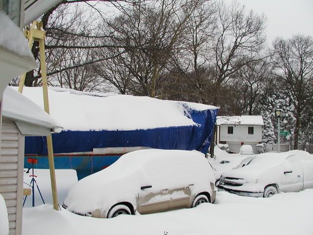

I use PVC on my Lancer 25. I built a "wall" that is about 3" higher than the stantions. A continuous horizontal pipe with verticals every 24" or so. The verticals stand on the deck and are tied to the toe rail. Then I take different lengths of PVC and bend them over the mast (laying down). At each end of the cross members is a tee with 45% of the "head" removed on a band saw so it will clip over the horizontal of the wall. A couple of turns with the handyman's secret weapon and I'm good. Then, I have a tailored cover that I made out of the compulsory blue tarp. It took me a few hours of layout time and another couple do sewing, but it looks much better than just a blue tarp. To attach it, I used bungee cord. When a fair sized storm comes, say 12" plus, I need to get inside and pus the snow off, but other than that, she does great all winter. Better than me, being on the hard for months at a time.

If you use the mast you need at least 3 points of support to stop it form bending on that one bad day and in general your frame needs to live through the worst day of winter when you cant get outside overnight while 24" of snow falls and it blows 67 MPH

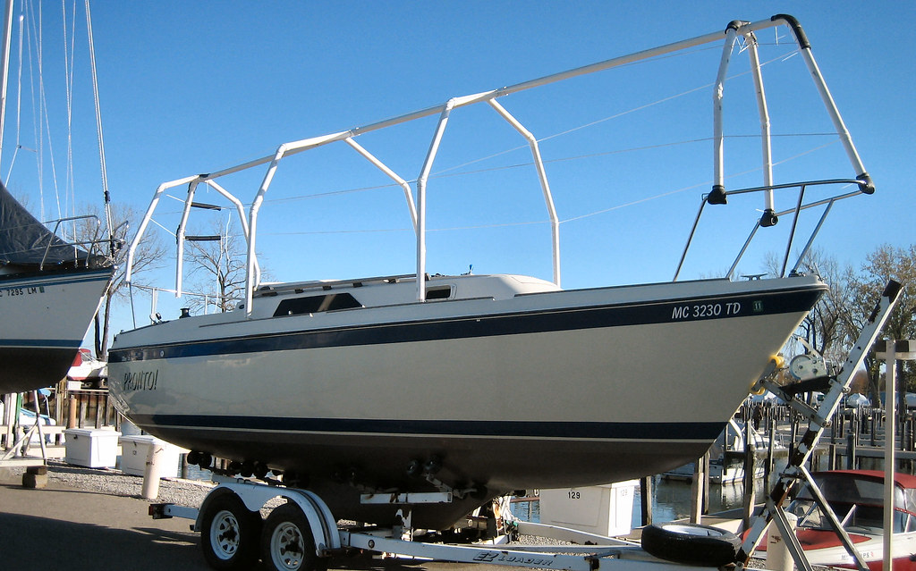

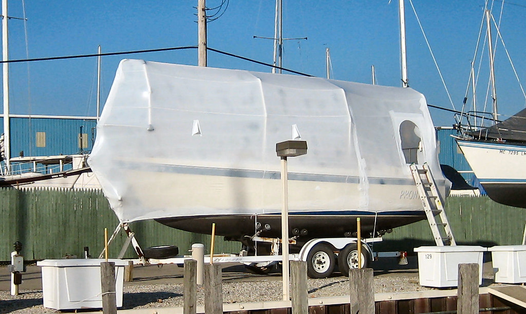

Here's my frame
I made it as high as I did for standing headroom so I could comfortably work on it in the off season. On mild sunny winter days in the 40s temps inside easily reach 70s. I'm currently waiting for the shrink wrap for its 3rd winter.
