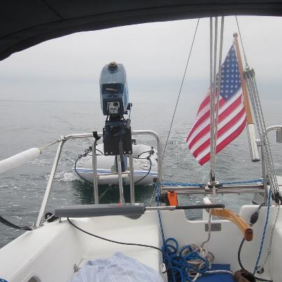

A board of 4" thickness (actual 3.5") will do it held by "U" bolts. Use treated wood and large washers on the bolts. The motor in the pic weighs 56 lbs. The mount was installed as temporary but has been there for 5 years and still being used.
