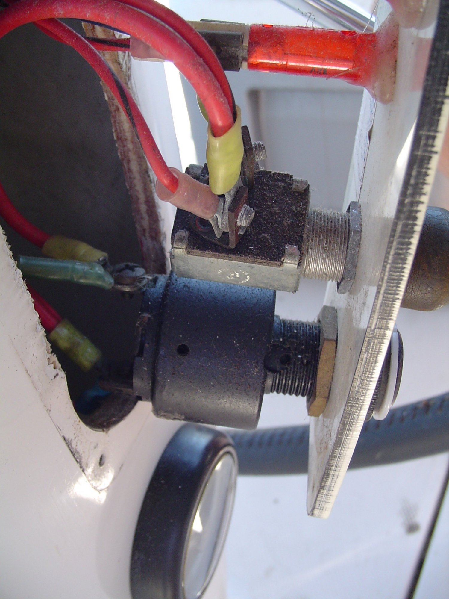

The starter button on my Yanmar 2GM20F seems a bit worn out…I have to press it on one side usually to get it to work. I always get it to start, but I have purchased a new one to install when I do my engine control panel project.
As others have said, wiring issues may be the more normal reason the button doesn’t work.

I agree with all who said “clean” the contacts. Mine were so bad (as Greg stated) I had to really press on the button to get it to work. I had to replace the starter button as a result of pressing to hard. It just failed.
One word of caution though, take photos of all the wires attached and there placement. If not you will blow the fuse near the engine when you think a wire goes where it shouldn’t.

The rubber weather proof cover is subject to failure.. Both from dry rot and usage cracks that are not very visible.. Options abound..I went to a Caterpillar dealer and bought my replacement... Think about it, an open dozer's starter switch deeps to be robust... Never a bit of problems.. After replacement the old button was dissected.. lots of corrosion !

I did the same with mine old starter button. Inside was more corroded than I would have ever believed.

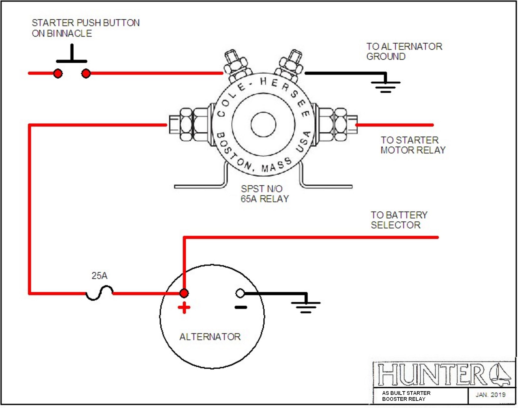

Just too many things to add a little resistance here and a little more over there. I achieved a few minor victories but after the last failure a few years ago, I took the easy way out and went with:

Hi Ralph. I am currently working through the wiring on my 2qm20. I'm finding several 'extra wires' and just poor wiring connections all throughout my harness. Looking at the yanmar wiring diagram seems pretty simple and straightforward, however in my hands the harness is a mess, only some of the color wire matches and the fuse block on the motor had a screwdriver bit in it when I found it.

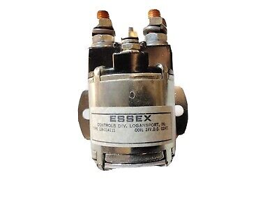

Sooooo, I'm pretty close to just rewiring the whole thing with new wire to the diagram but also thinking I should add this relay. Is that what you did or did you just add the relay to boost the current to the starter? I'm getting current to my keyswitch but then not after it, ordering a replacement now, also replacing the push start button.

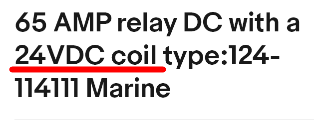

I think I found the relay you are using, is this it?
Jan 4, 2006
7,870

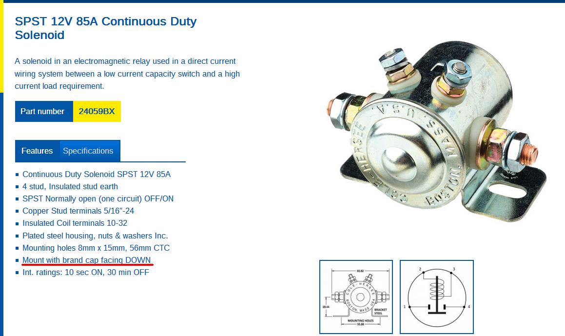

Ah, so near yet so far. That relay has a 24V coil which requires 24 volts to close its contacts.
You only have 12V from your batteries so, no cigar. You need a relay with a 12V coil. This is what I have for something like $45.00. A little more solid in construction.

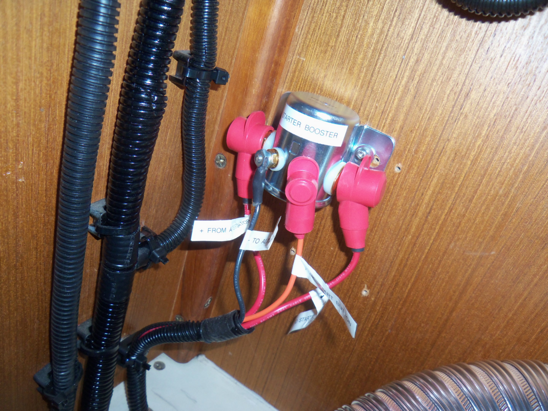

I see your 25amp fuse between the relay and the alternator. is that a blade fuse? do you still have a fuse block on your engine? I'm not exactly sure where in the chain of positive lines it should be, or if it's even the right thing.
Just a glass fuse with a fast blow.

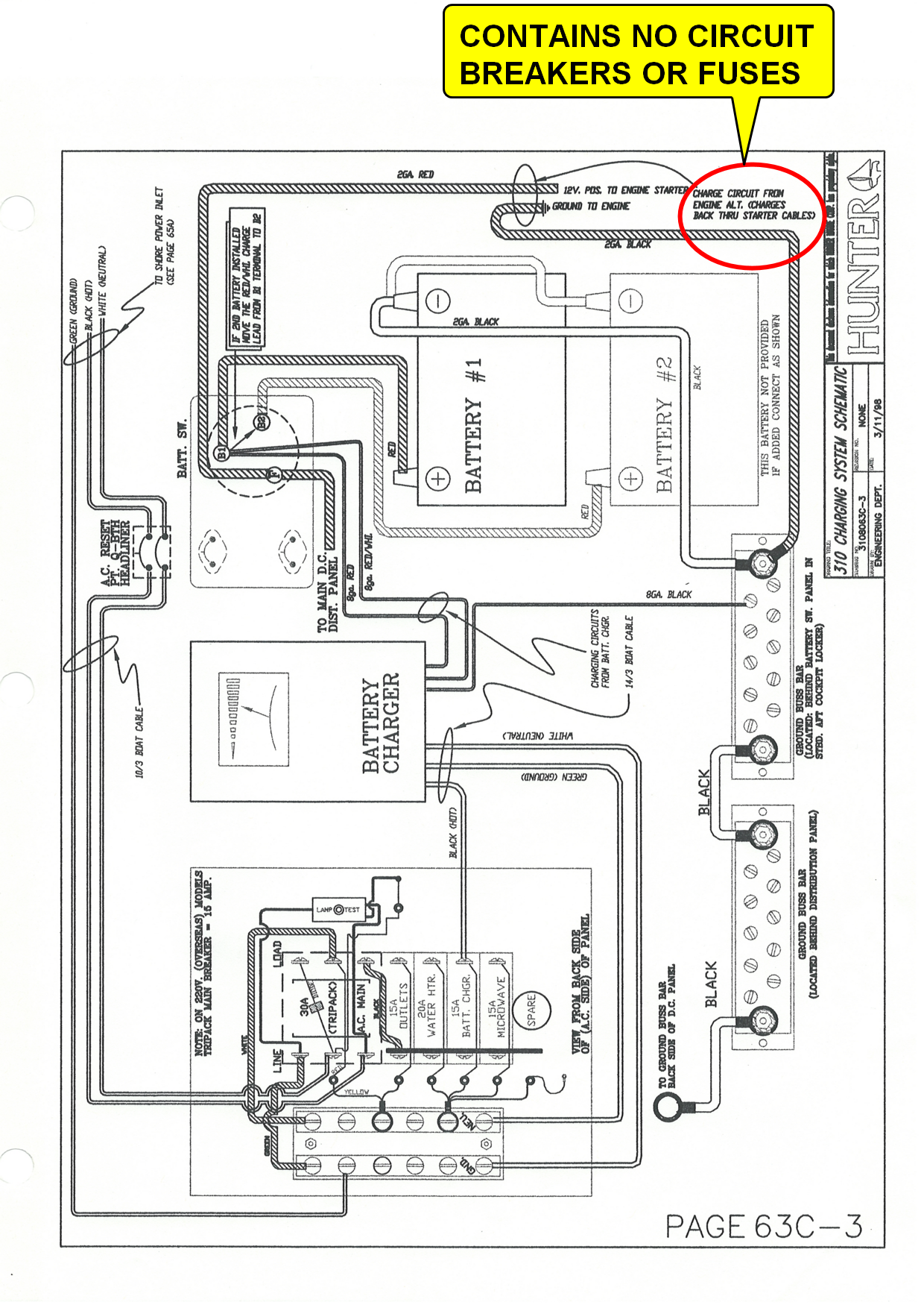

This 25A fuse is the only fuse in the line which takes its power leading from the battery, along the line which supplies the battery from the alternator and up to the 65A relay. Why there is no 50A fuse near the battery to protect the line leading to the alternator is still an unknown after 25 years.
My only defense is that this area is kept clean for observation and minimum risk of a short in this area. Yes, I know I should install a 50A fuse but there's so much maint. to be done before this.
