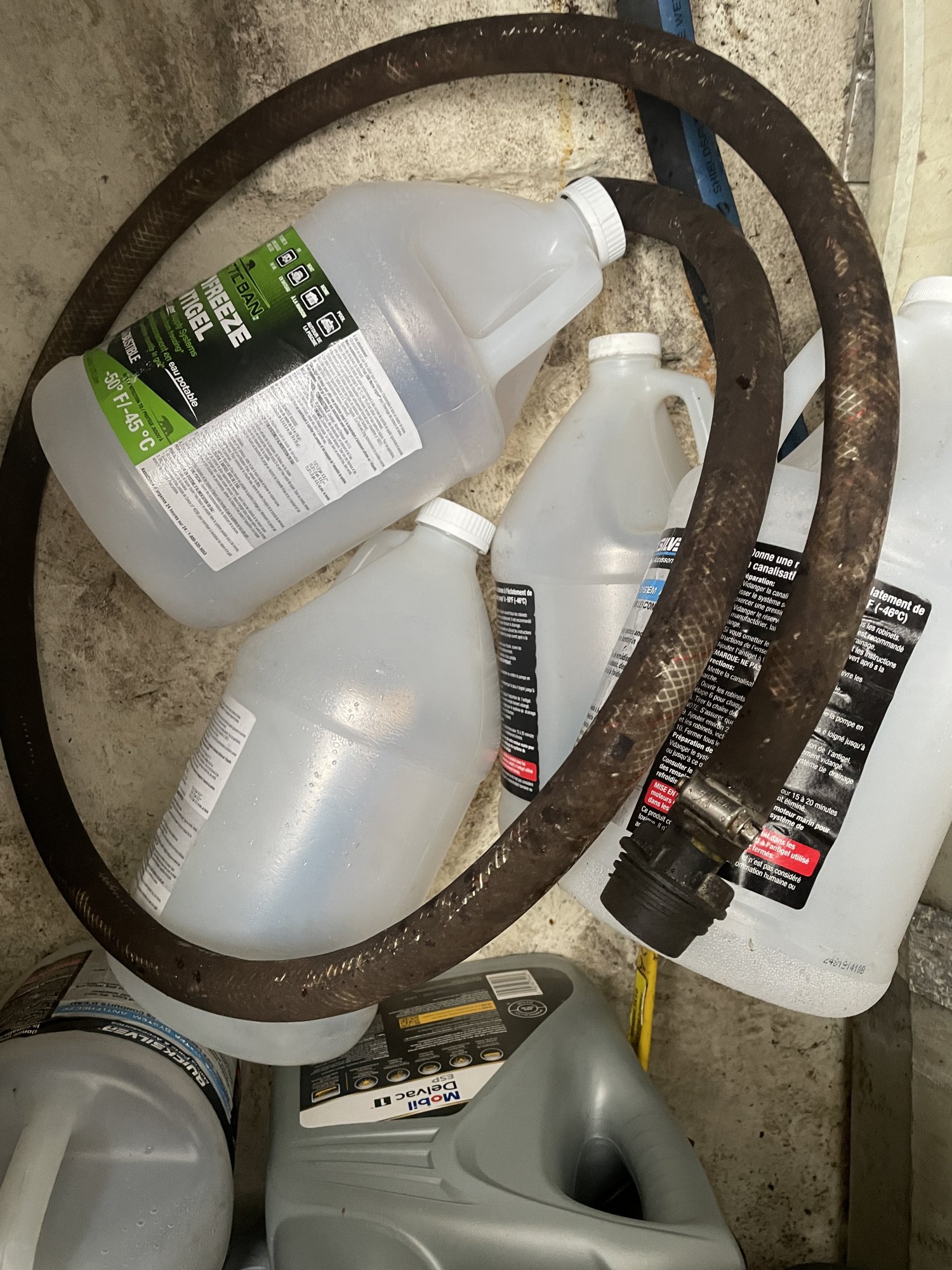

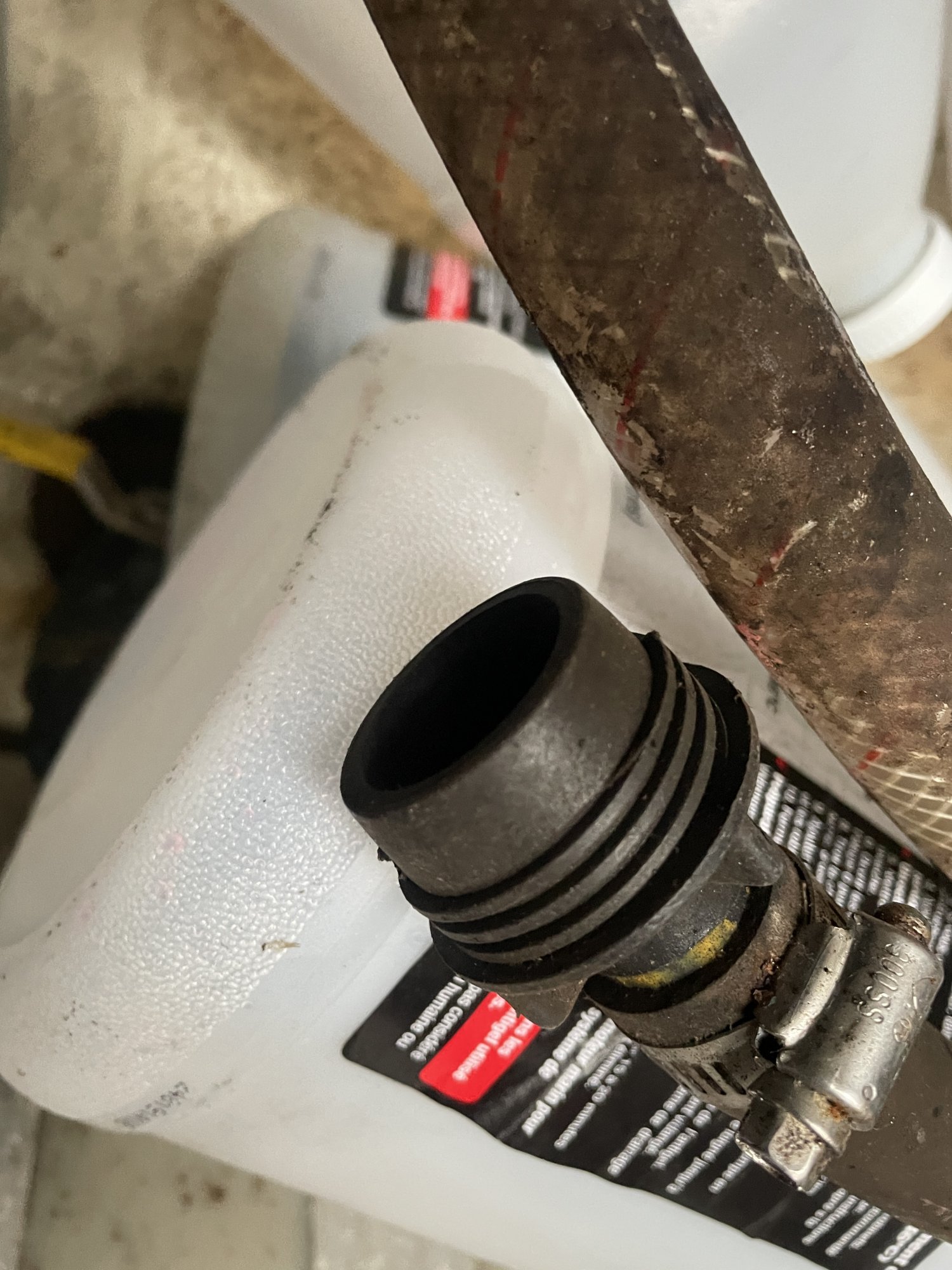

The photos are of what I assume to be the dip tube to feed in thru the deck fitting to enable me to utilize the pump out station. I am assuming there is not an installed dip tube in the tank. Are there any updates or improvements I should make in order to pump out and flush prior to replacing the macerator pump?

There is a hose from the deck fitting to the top of the waste tank but I don't know that there is an internal tube to the bottom of the waste tank.

The deck fitting is your pump out. What else would it be for.
Pumpout is easy. Then replace with new one and rebuild the old one (impeller kit) and keep as a spare.
All easy to do.
I have never seen a holding tank without a dip tube installed.
I have never seen a hose that you put into the deck pump-out that is required to pump the holding tank.
Have you ever pumped out from the deck fitting using a regular pump out station?

Thank-you - We have never pumped out through the deck fitting at the pump out station so we will try through the deck fitting. Worst case we will have to feed in the hose through the tortured connection to the top of the waste tank. There was a sale on macerator pumps so at that time I purchased a spare, then I will rebuild the old one as the motor still runs.

Thank-you - we are going to try the pump out. Worst case no dip tube and I have to insert this hose that looks like it was used in the waste tank. I have a spare macerator pump so I will replace and then rebuild. When we purchased the boat 12 years ago there was damage due to freezing so I had to rebuild the pump and replace the hoses from the tank to the suction and the discharge. there was no damage to the waste tank, luckily. I had to repair damage to the swim platform shower at that time as well. Since then I have always winterized and ensured there was some rv antifreeze in the waste tank come winter

1) As others have said, if you have a hose from the tank to a deck pumpout fitting, you should be good. Not having a tube to the bottom of the tank would render the pumpout useless. Unless of course, the hose runs to a fitting at the bottom of the tank (as mine does)…then no dip tube needed.
2) I have a little hose and fitting similar to your photo that I use for winterizing my potable water system. I disconnect a water hose from the water tank, connect the short hose to the water hose to lengthen it and stick the end in a jug of AF…and turn on the pump and open the faucets…that way, I am not putting AF in my water tanks. I wonder if your is used for something similar, given it is sitting amongst a bunch empty bottles of AF…
