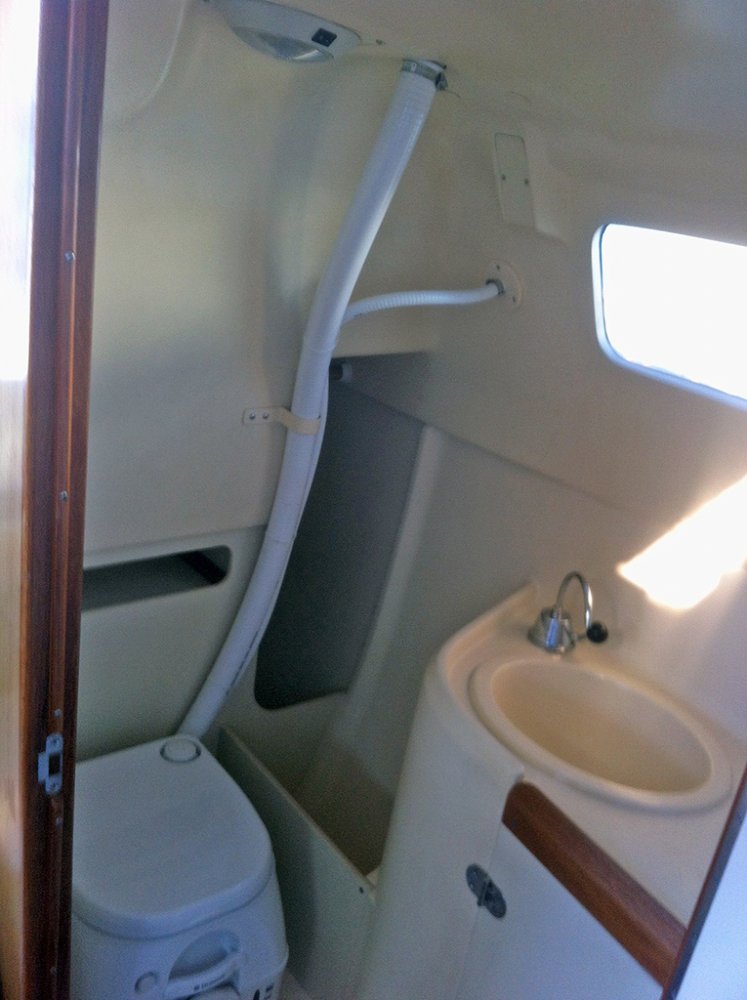

Easy to do
I have a Thetford port-a-potty with the five gallon holding tank...do you think it is possible to rig it to use a standard pump out?
If you're even a little bit handy with a hole saw, installing a pumpout fitting in the tank would be easy and very inexpensive to do, using a li'l doodad called the Uniseal and a couple of pieces of PVC: check it out here UNISEAL Uniseal Instructions
If you're willing to also run a vent line and pumpout line and install a deck pumpout and vent thru-hull, you'll have a fully functional "MSD" portapotty that you won't have to move to the cockpit to pump out.
