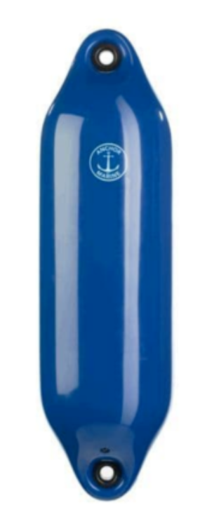

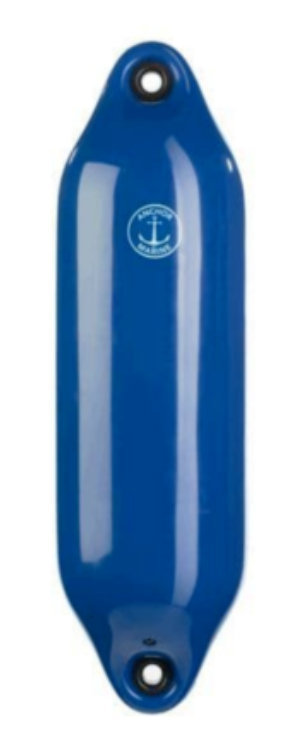

In a week or two I will need to inflate a bunch of fenders. One of them is very large. Would I better off using a high volume pump such as one for a dinghy/air mattress/etc or one that's high pressure for bicycles/balls/etc?

Most of them are probably 12"x24-30". The big one is like 36-40"x16". If I go to the yard tomorrow I can grab a pic

Bike pump does just fine……. Unless you have a 5 footer. Then use a compressor.

A high volume pump would be preferable as you only want to inflate to a very low pressure. This is a quote from the Polyform US website:
“Our buoys and boat fenders should be inflated to 2.1 lbs/0,15 bar of pressure. When inflating without a pressure gauge, fill the buoy or fender until the walls are fully expanded, but make certain you can depress the wall at least 1/4 inch with light hand pressure, or measure the circumference and compare it with the inflation chart for proper pressure. Over inflation will reduce the performance of the product and may cause premature failure.”
Polyform US Fender Inflation
