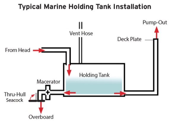

In order to use a pump out station do you have to close the through haul valve after the Macerator , or can you leave the valve in the open position. Thanks for any advice

ACE... Let's think this through. You have the Thru Hull open. The Macerator is open to the Holding tank. You open the pump out and start to suck out the contents. Seems to me that the contents will get sucked out and then the sea water will start to in flow and you'll soon be sucking marina water which is trying to fill the holding tank from beneath the boat.
I'd close the thru hull for the Macerator.

Assuming your system looks like the diagram below, make sure the thru hull valve downstream of the macerator is closed. That is the same set up on each of my two sailboat holding tanks and the thru hull valves on the discharge of each macerator are kept closed.

Respectfully, I believe your drawing is somewhat incorrect technically.
To the best of my knowledge, holding tanks never have discharge fittings at the bottom of the tank.
these connections would be made via a dip tube through the top of the tank.
The reason for this is that you never want the possibility of a slightly leaky fitting dumping sewage into your bilge.
Hmmm. On my daughter's previous 1982 C-30 the discharge line (the line to the deck pumpout fitting) was at the bottom of the tank. The "discharge" from the head to the holding tank was near the top of the tank. In other words the drawing referred to correctly mimicked the system on the C-30. That said, your description is a much better design for the reason you list.

The schematic drawing is "conceptual" and may have a dip tube not shown on sailboat manual plumbing drawings.
If you check marine catalogs, you'll find that the "standard location" for most off- the-shelf tanks and OEM tanks on production boats is all fittings in one end of the tank, inlet high, discharge low, and vent high in a corner for as long as holding tanks have been required (which has been 40 years now). Discharge on top with a dip-tube is actually a fairly recent innovation (I first head of it and began recommending it in the mid '90s) seldom used by OEMs 'cuz it costs a bit more and because additional clearance of up to 5" above the tank is needed for hose fittings--space that isn''t always available.
On top with a diptube is my favorite way to do it when there is enough clearance above the tank 'cuz it eliminates standing sewage in the tank discharge line...and whether the discharge fitting can go on the top or not, I also recommend putting TWO discharge fittings in a tank that's plumbed to dump at sea 'cuz it eliminates the need for a y-valve in the pumpout line.
