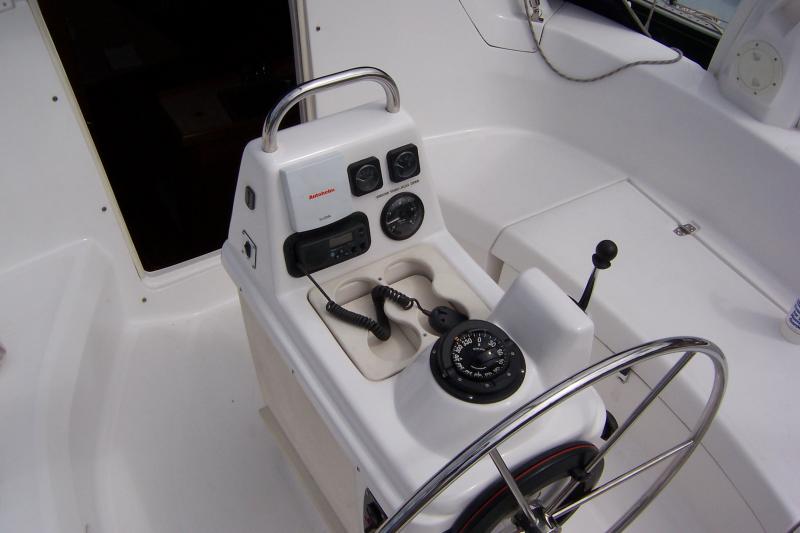

I need help figuring out how to route some wire. I have had my 1998 Hunter 310 for about 8 months and finally installed a Garmin Echomap 50s GPS today on the pedestal. No issues with the installation.
The boat came with an old garmin fishfinder and transducer (installed above the companionway). I want to route the transducer wire from where it goes into the old fishfinder and run it into the pedestal so I can use the new unit to as the fishfinder and decommission the old one. I know I will need an adapter. My problem is actually running the wire. I can't for the life of me figure out a way to get there.

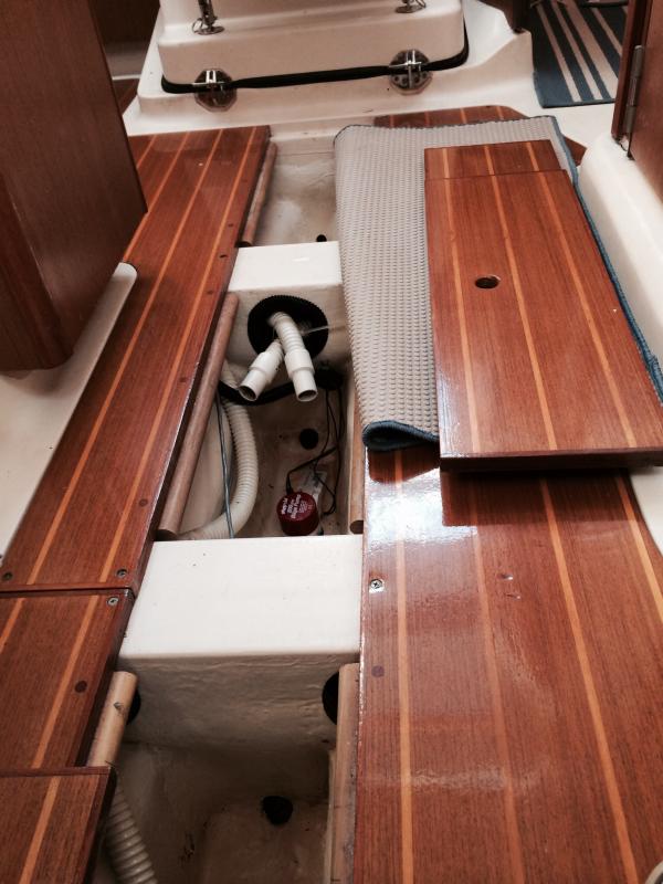

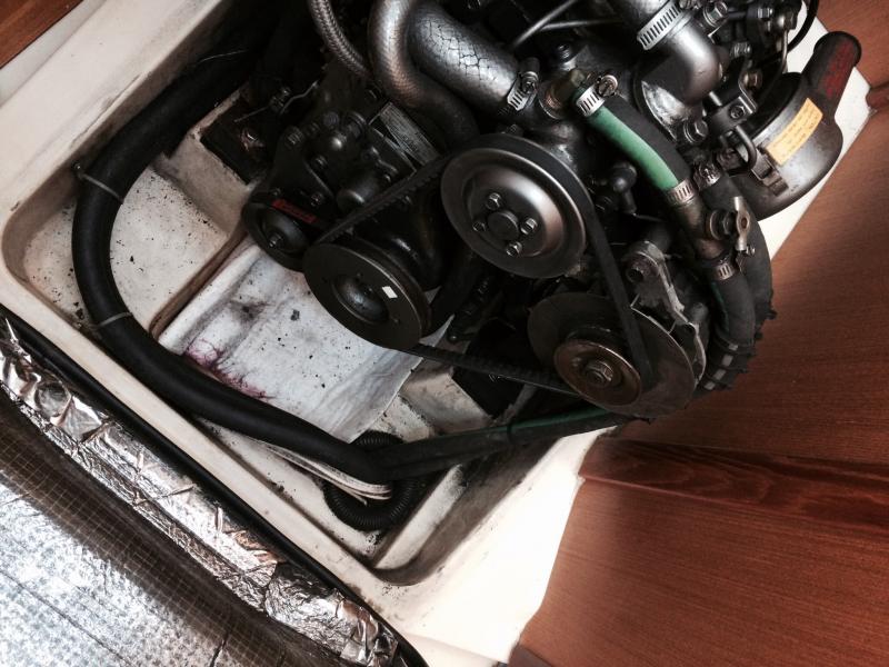

The pedestal is identical. The transducer is just forward of the post. I can easily run the wire from there alongside other wires in the bilge. Once I get to the motor, I cannot figure out how to get under it, and to the aft cabin. Once I am under the aft cabin I am home free, as I can get it up and around to the pedestal.
How do I run the wire under the motor?
