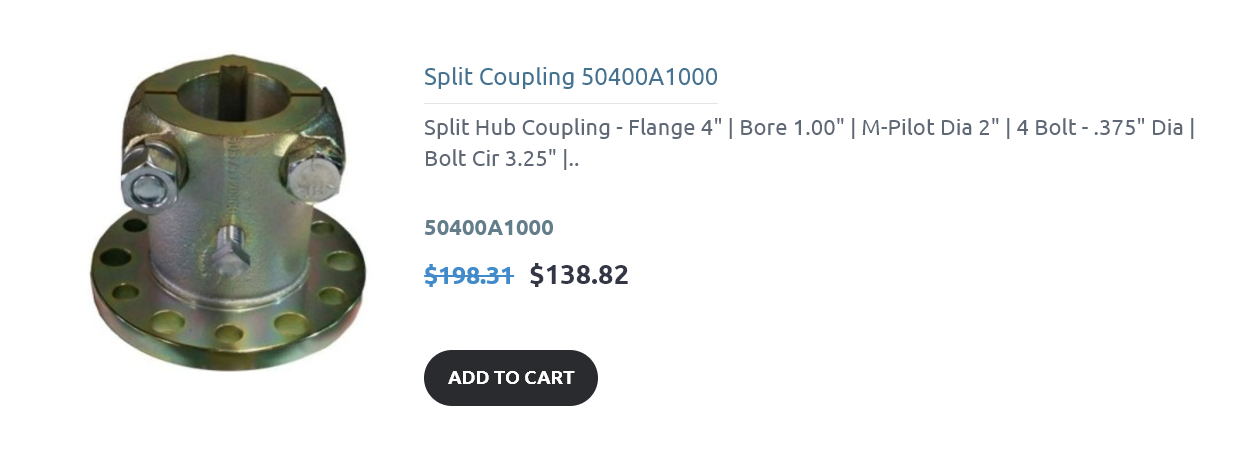

Take the coupling off the transmission and then get one of these tools. Makes getting the flange off very easy. If you don't have a split coupling, spring for one, they make installing and removing the coupling much easier. After putting everything back together, spray the coupling with CRC Anticorrosion Spray.

This is why you replace the coupling with a split flange, it is not necessary to pound on the shaft, coupling, and transmission ever so gently. Pounding on the transmission is seldom a good idea.

For sure, if I were to replace the coupling again, I would use a split coupling.
