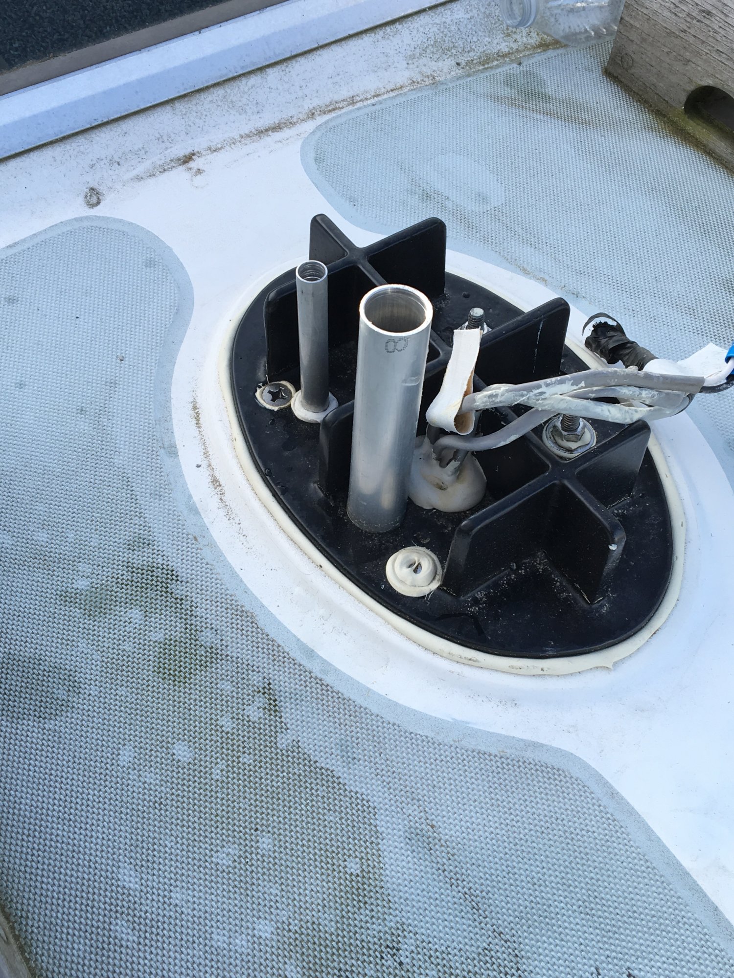

I have a deck stepped mast. I know water seeps down the inside of the mast. There are weep holes on the step and mast base to let water escape out onto the deck. To stop water from leaking down into the boat on the wires I installed some raised tubes.
When you indicated the wire fell down inside the cabin it got me to wonder. How is the wire configuration to let it go through the deck so that water does not leak in?
Knowing that it might clarify why you experienced an issue trying to run the fish tape.

I too get a bit of water in the cabin coming down the inside of the mast, but it started when I lost my steaming light, and the access hole became exposed. The water "should" stop once I get the light back up. Thanks for the picture.
