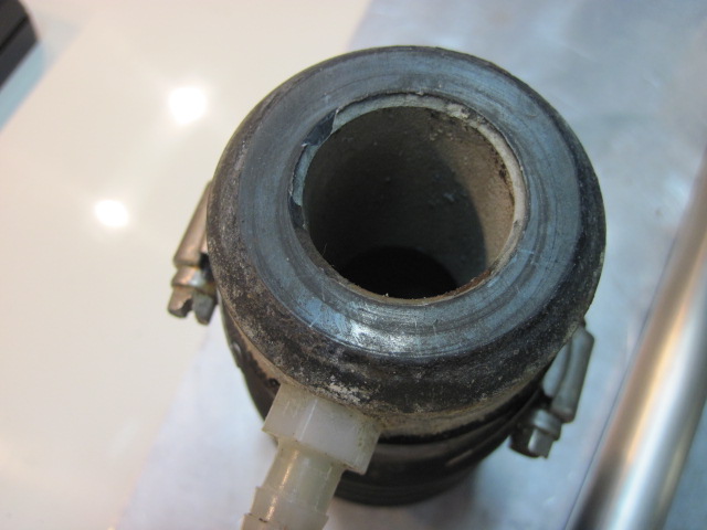

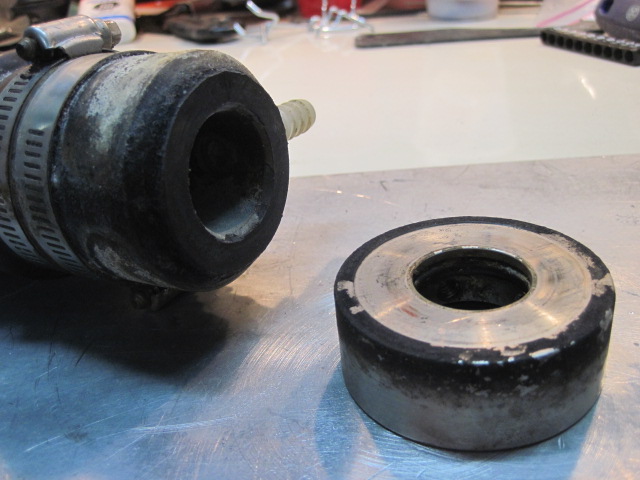

Was checking the PSS seal and noticed a lot of carbon around the collar. So pulled the flange and shaft to get a better look. NOT GOOD. Appears the collar has been tearing things up. Not sure if this can be fixed or just bite the bullet and buy a new one. There are small groves in both sides that was acting like sandpaper. Any ideas out there?
Adding misery to the mix, it appears my shaft alignment is off. Cutlass bearing is shot. The engine side is almost worn to the brass and will need to be replaced. Along with this the engine will need to be aligned.

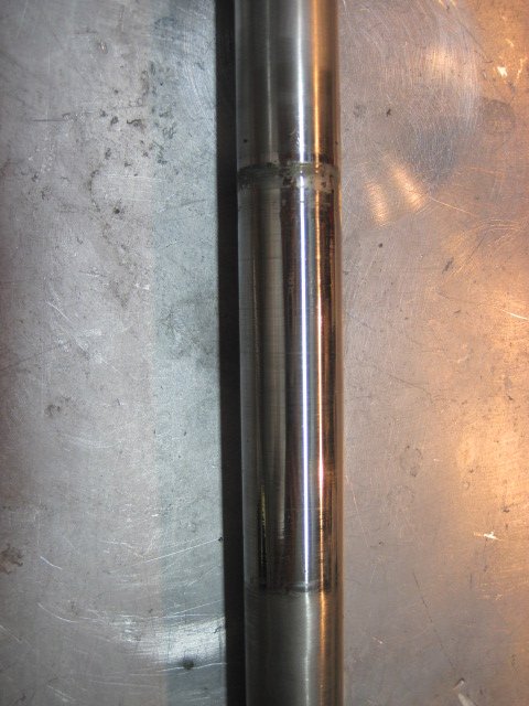

Need to take the shaft to the machine shop and get it cleaned up. There is a groove of a .012 inch depth where the cutlass was rubbing. Hopefully that is all that will need to be done. Have no idea what a new shaft would cost.

Jim, it looks like the seal ran dry a while.. I'd be sure to burp it and make sure that the vent tube is clear.. I think that the carbon face can be replaced fairly easily and cheaply? The hard rotating part can be cleaned up, lapped, and re-used. The shaft can be "flame sprayed" to build the Cutless area back up and re-ground round by a good machine shop. We've done that with aluminum bronze powder and had very good results. it may be that a new shaft might cost less than the repair, because a shaft is a pretty simple thing.. Many yards carry shafting with the prop taper and threads already machined on. It is then a simple thing to cut it to length. Check your coupling fit on the shaft.. probably going to have to have a new coupling half cut/fit as well. Good Luck..
EDIT when re-installing, check that the bellows compression is correct so that the faces aren't overloaded.
