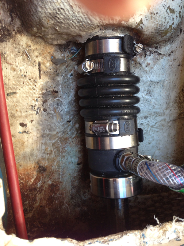

Hold on here.
If you cut the shaft and replace the cutlass you most likely will have to pull the motor to access the new shaft and install the new transmission coupler. I can't imagine it would be easy to do with the motor in place.
A few months back I refit my stuffing box and coupler. I also could not get the box or coupler off the old shaft. I used a Sawzall and cut the trans couple off. It was made of some fairly soft metal.
I then slid the stuffing box off the end as well as the hose for the shaft log. Replaced all the odd bit and cleaned and repacked the box before putting on a new coupler.

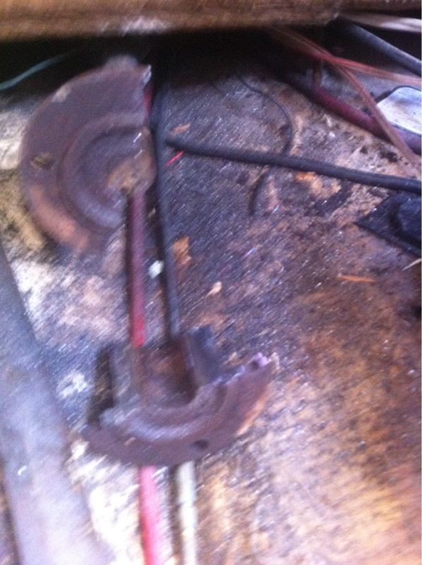

Hey folks,
Happy New Year! Just wanted to post an update; I cut the prop shaft out of the boat yesterday. Really surprised at how easy it was. Used my 4 1/2" angle grinder and it took all of about 2 minutes. Now I have to weigh my options and find a replacement shaft etc.
