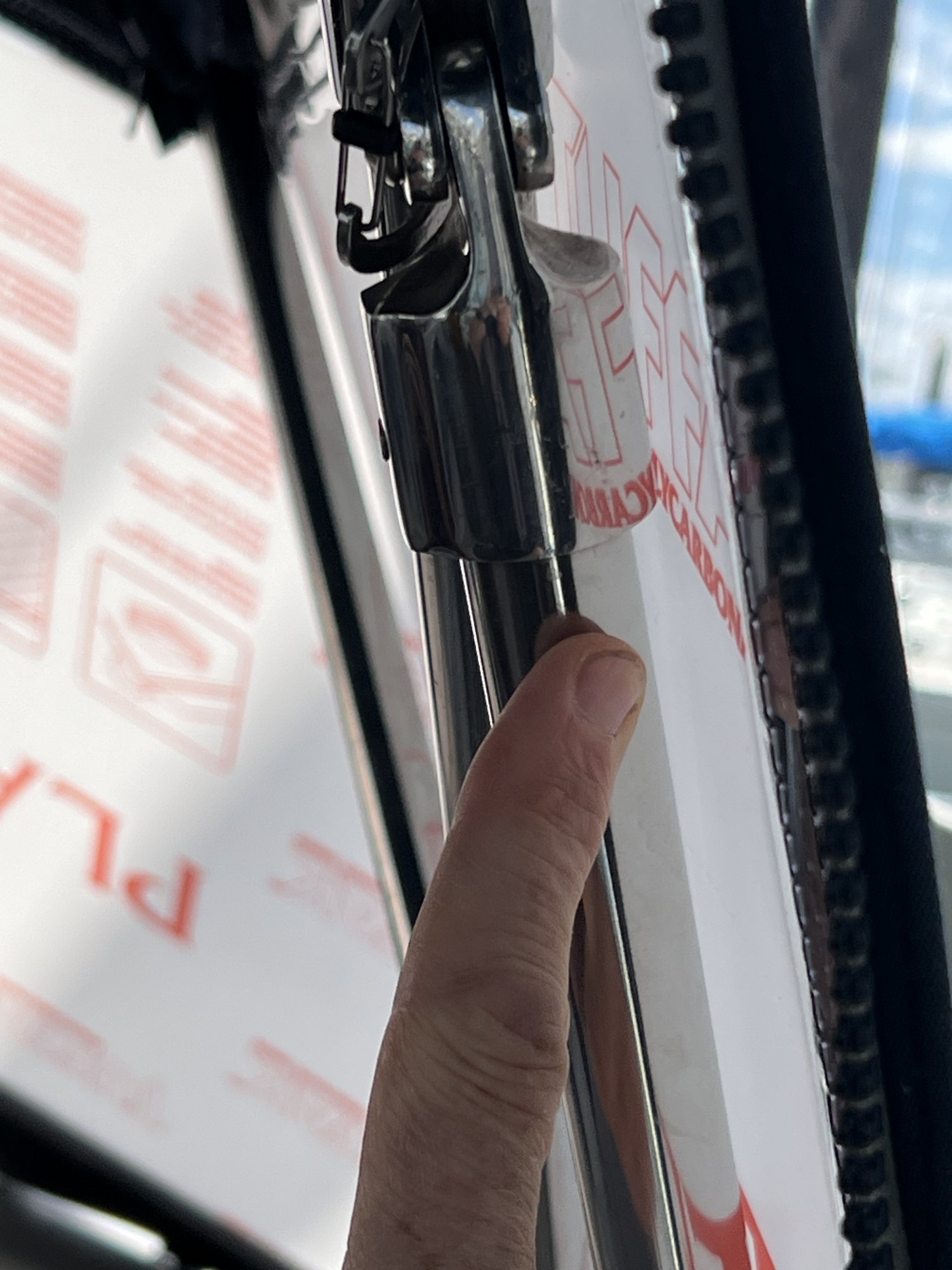

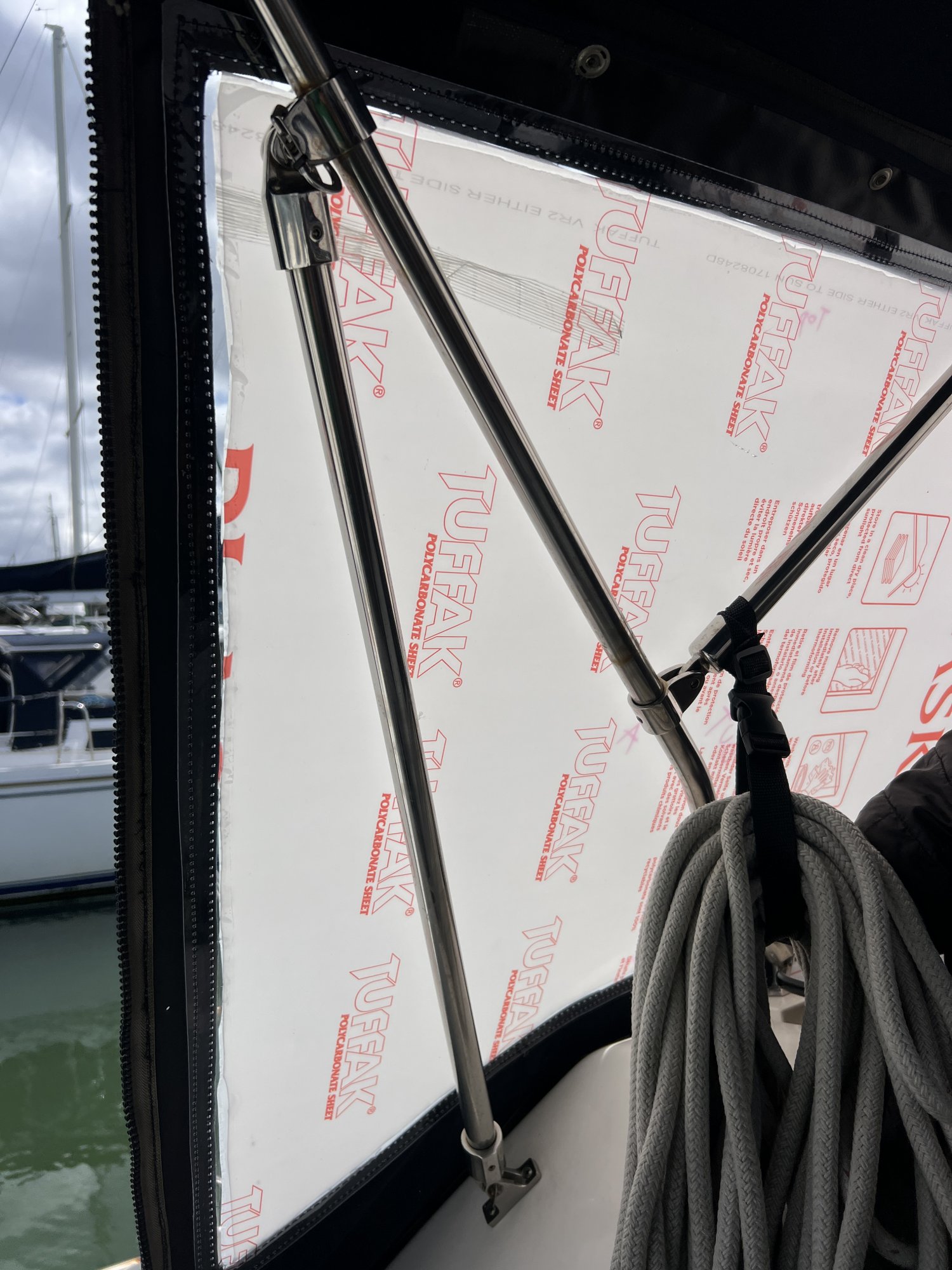

We just installed new dodger glass, and the side glass panels rest against the dodger frame rods and connectors. Does anybody have experience:suggestions as to how to protect the new glass from getting scuffed from contact with the frame rods?

There are commercially available plastic(rubber?) clip on feet to help keep a distance between the frame and windows available
14,157
They are available and hard to find. They snap on to the tubing and keep the window away from the frame. Unfortunately I can't remember what they are called. They can be seen in the photo, the white blocks attached to the frame.

Sailrite has them in ⅞” sku #203311 for 4.45$ for a pack of 5
or 1” sku #203411 for 5.95$ for a pack of 5
My local chandlery has them in stock as well, I am sure they can be found on Amazon

Much thanks all - I will pick some up. Looks like the only place online is direct from Sailrite. I will check my chandlery first.
