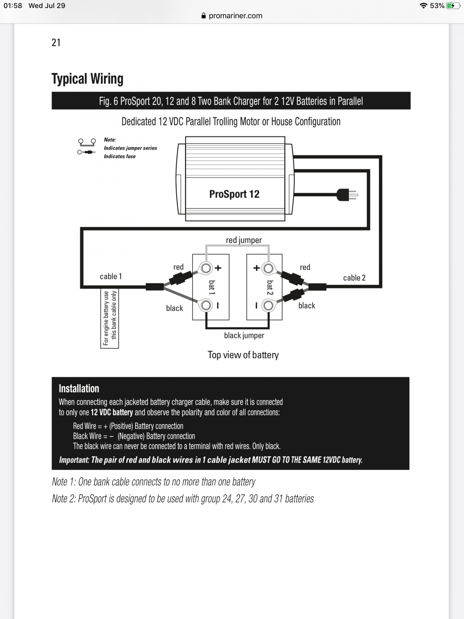

I am thinking of doing a 31 for the start battery and two 24s in parallel for the house. I know the manual says to do each battery with a cable each from the prosport but I only have two cables and 3 batteries. Has anyone tried to do two batteries in parallel with one outlet from the prosport?
