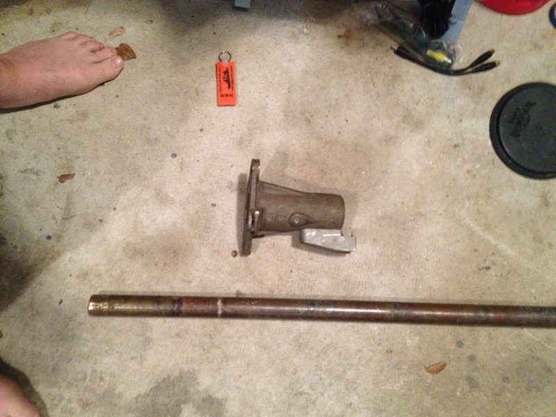

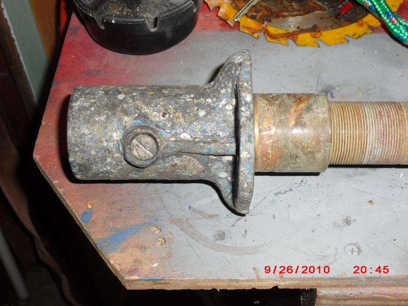

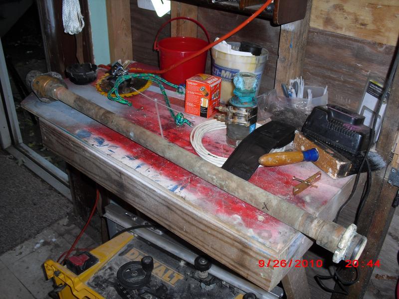

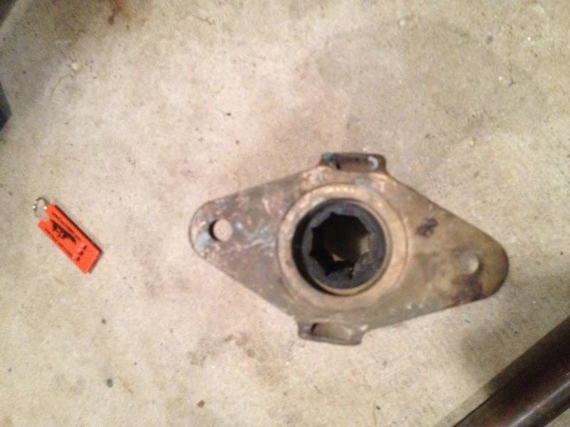

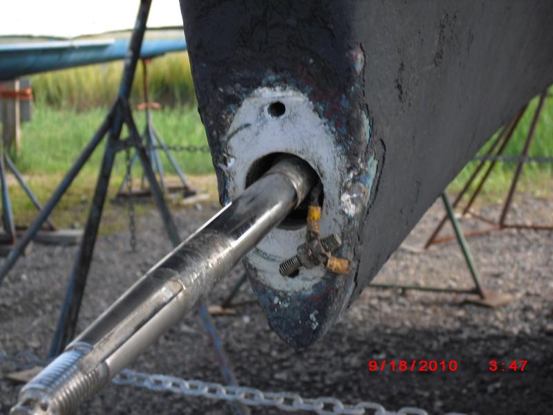

Wild, I share your concern, 2 years ago my boat started leaking badly, the shaft log was held in with only 1 of 2 bolts, water was getting around the outside of the tube, here are pics of it. What a bitch getting at that thing. If u look at the place where the shaft log goes over the prop shaft, I put the bolts into the holes, and had another guy inside with a 3/8" rachet, with a couple of extensions = almost 5' with a swivel socket, I put heavy grease in it so the nut would not fall out, my friend was inside the engine compartment with the rachet next to the tube blind.The lenghth of the tube bridged my center cockpit. I was on the outside turning the bolt, took 3.5 hrs to get 2 nuts on, I hope yours is more accessible. What I would recomend is to buy a shaft log, and cutlass brg. It will have a female thread, buy a piece of same metal pipe as shaft log,( probably bronze?) size it to fit in boat, and have the 2 OD,s of the pipe threaded, so u can screw on an extension say sticking out 2" for your stuff box to clamp on, the other end into the shaft log. Install the 2 threaded ends with pipe dope, tighten against each other, and bolt in the shaft log.... Sounds complicated, but if u can get at it its easy.. REd
