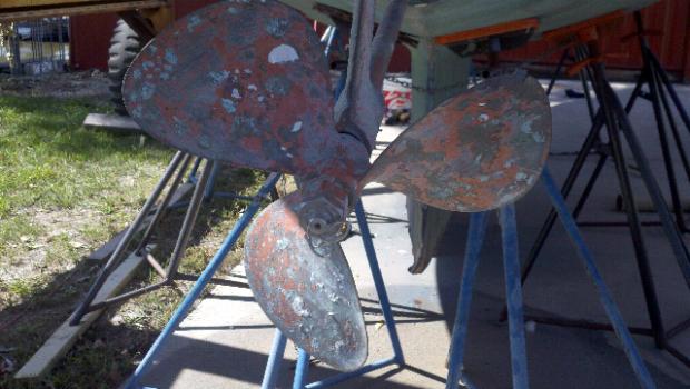

My H37c has a 3 bladed prop which is about 12 in diameter. It needs fixed. One of the tips is broken off.
The boat had a 2 bladed prop inside in a cabinet.
Can someone shed some light on the correct one?
Rick
Jun 3, 2004
890
Hunter 34 Toronto, Ontario Canada
Looks like the PO changed to a 3 blade and kept the old (and possibly original ?) 2 blade as a spare. Just as I did only the "spare" hasn't made it to the boat yet.

Yes, the PO very likely changed to a three blade prop and kept the old two blade as a spare. Here is a good prop company to check with regarding the repair of your prop or buying a new or used one. These guys are very good and will answer your questions. A three blade prop is much better than a two blade. The two blade will work of course but not as well when under power.

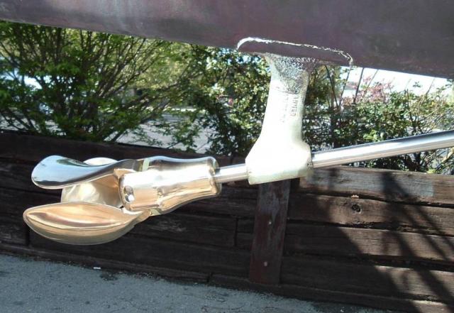

Can't remember which engine but I think you have the 3QM30 or 30hp. My prop guy, Flex-O-Fold, recommends 15x13 for our 18000+ boats with 30hp.

Thanks guys. Ed I noticed you said flexnfold 15x13... is that a fixed 15x13 or flex?

A folder Rick. Had the Flex-O-Fold two-blade, also 15", on the 2QM20. When I installed the 3YM30 I sprung for the new 3-blade.
Jun 2, 2004
5,802
Amazing difference from fixed Rick. I had a Michigan fixed 3-blade for awhile so I know how much better the folder is. But it is expensive and there is nothing wrong with a good fixed blade prop.

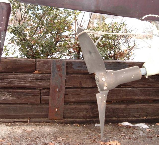

1,483
gear ratio
I have a 2.46;1 tranny on my 31hp Westerbeke. 15 x13 campbell sailer redlines easily, doesn't get anywhere near hull speed. Gonna go for externally adjustable pitch feathering prop. Start at 15 X 15 and see what I get

My Flex-O-Fold makes 7 knots at under 3000 rpm. Never pushed it beyond that. The good thing is that in tough conditions it will always do 6 knots. Obviously backing is much improved over a 2-blade and even the 3-blade fixed I was running. All this with the 3YM30.
May 31, 2007
783
Hunter 37 cutter Blind River
