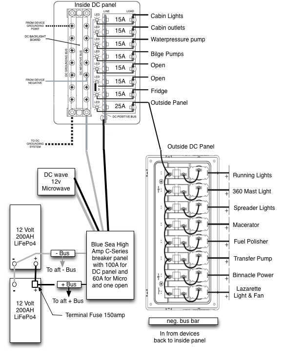

Hey, I have been researching and studying how to redo the 12V system on my 78 Hunter 33. If I could get a few people knowledgeable with the subject to take a look at my diagram and point out what I may have missed I would be grateful.

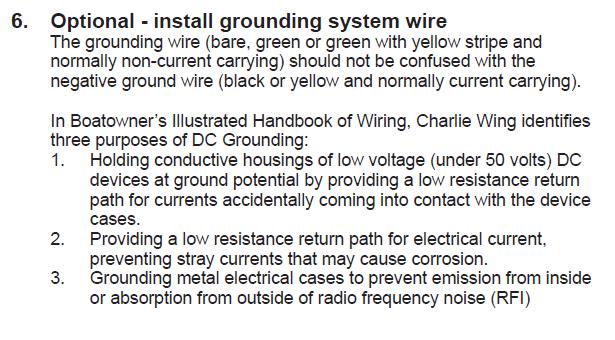

Also, there is a Ground buss on this blue sea 12v panel, where should that be connected to?
