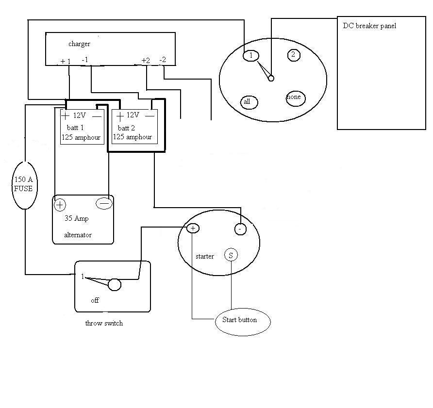

This is the electrical system I intend to hook up on Friday. I am going to motor my boat across Corpus Christi Bay, on a 30 mile trip to a boat yard. I have no sails on the boat right now. So I need this system to hold up.
The alternator is internally self regulated.
If there is anything wrong with this set up PLEASE let me know.
I have no way to monitor the battery banks and alternator as of yet.
If I hook up a voltage meter on the battery banks + and -, will this allow me to be able to see if the alternator is charging ok and not overcharging?
What should the range be in for the battery voltage?
I have 2, 125 amp hour 12 volt batteries wired in parallel. Is my 35 amp alternator going to get burned out charging these or will it be ok? It is a marine alternator that came on the engine, hitachi brand.

Just make sure the alternator is putting out and you should be fine, the voltage should be 13.6 or higher and if the battery's are fully charged there should be no reason for the alternator to be over loaded.

The fuse in the starter circuit may be redundant. The alternator will take care of its self. If you daily draw exceeds the alternators output you might end up with dead batteries. I monitor my batteries with a digital voltmeter only. If the voltage drops below 11.8 I start the engine. Simple and has worked for me for 9 years.

Sorry I didn't get back to you on another thread. What you have drawn will be fine. The only change I'd make which isn't important as a temp setup is connect the alt across both batteries, not just to one but no problem in the short term.

Ross, Do you have the digital voltmeter hard wired and mounted to something, or are you just handheld checking it? IF it's mounted where did you get it. (You and I think alike when it come to spending money);)
Why would the fuse be redundant? I wasn't going to put it in originally but I saw one in a wiring diagram so I thought it must be necessary for USCG regs, or at least a good idea.
Don, The alternator is connected across both batteries. If you follow the lines around the batteries, they are wired in parallel.
I was reading at Borders tonight about sailboat electrical, and I am going to add a regulator charger that has 3 steps, I think they are called smart chargers. But not for a few weeks. I am going to make this trip with this configuration.

Hermit, I have a couple of binding posts that I connect a hand held digital DVM to for monitoring purposes. My electrical panel is convenient to allow this. A good DVM only costs about 30 bucks and is essential to electrical trouble shooting.
A fuse for the whole boat makes sense but the battery circuit is about as fail safe as they get. We discussed this about a week ago and came to no concensus as to the size of the fuse because of the range of loads. The fuse size should be chosen to protect the wire from overheating.

Hermit, Looks Good
for your intended, and limited use.
The link is for your long term planning. Have the alternator AVOID THE 1-2-b SWITCH.
Link: http://www.c34.org/projects/projects-electrical-system-upgrade-2.html
Stu
PS Your 1-2-B switch is wrong, only three posts on the back, NONE makes no sense and should be deleted, the DP panel should come off the B (or common) post, as well as the wiring to the starter.

Stu, I haven't even touched that switch yet. All the wiring I will do is limited to what's in the diagram except I will not be routing anything to the DC breaker box. I haven't tested it yet.

23,524
I understand you haven't touched the switch
and the sketch is to show us how it is wired. Only reason I mentioned it is that as you grow into your boat you'll find yourself making more electrical sketches. Just get the wiring straight in your head and your wiring diagrams.
Many people get "confused" with the 1-2-B switch anyway. There are only three points of wiring connection to the switch: 1, 2, and common (B). There are four POSITIONS to the switch, 1,2, B and off. However, OFF is NOT a wiring point of connection, it is a switch position.

Sounds like you have it covered
Sounds like you got it covered, and what you have drawn up should work fine. The alternator will not be overloaded. I have a standard 35 amp Hitachi on a 450ah bank. I do second the advice about getting tow insurance. It is the best 150 bucks you will ever spend.

Stu, I undertsand how the switch works. I know there won't be a wiring point there. Thanks for checking with me though.
