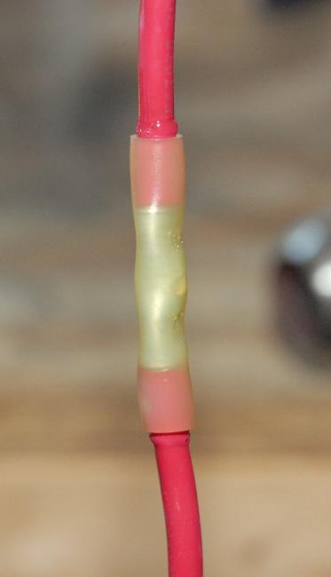

Hi all,I'm currently in the process of writing another article for my web site about crimping marine wire and terminations and thought I post a couple of photos that might be an eye opener for some. While I was not surprised by this I'm going to guess some will be.I used an adhesive lined heat shrink butt connector and a two lengths of 10ga marine grade UL listed tinned wire. To make the crimp I used a pair of Ancor Marine ratcheting crimper's that are specifically designed for crimping heat shrink connectors. The crimpers are model #702010 and can be seen here: http://www.ancorproducts.com/scpt/ProdPage.php?loadItem=702010_AncorI wanted to show how strong properly executed crimps are, for the many who doubt the strength. I decided the best way to show the strength would be to hang a few of my anchors from the crimped butt connector. See the next photo!I think the photos speak for them selves.Full Article with photos here:All About Marine Wire Terminationhttp://www.pbase.com/mainecruising/wire_terminationThis is the crimped connector that I hung the anchors from.
