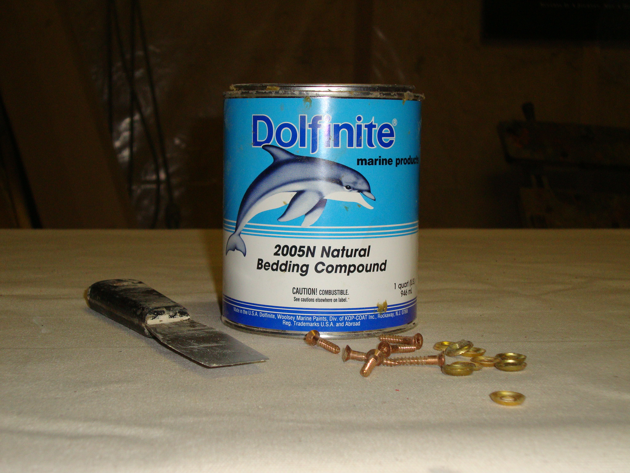

Think Dolphinite! Under the track and in the bolt holes and behind the washer under the deck.
Works wonders!
