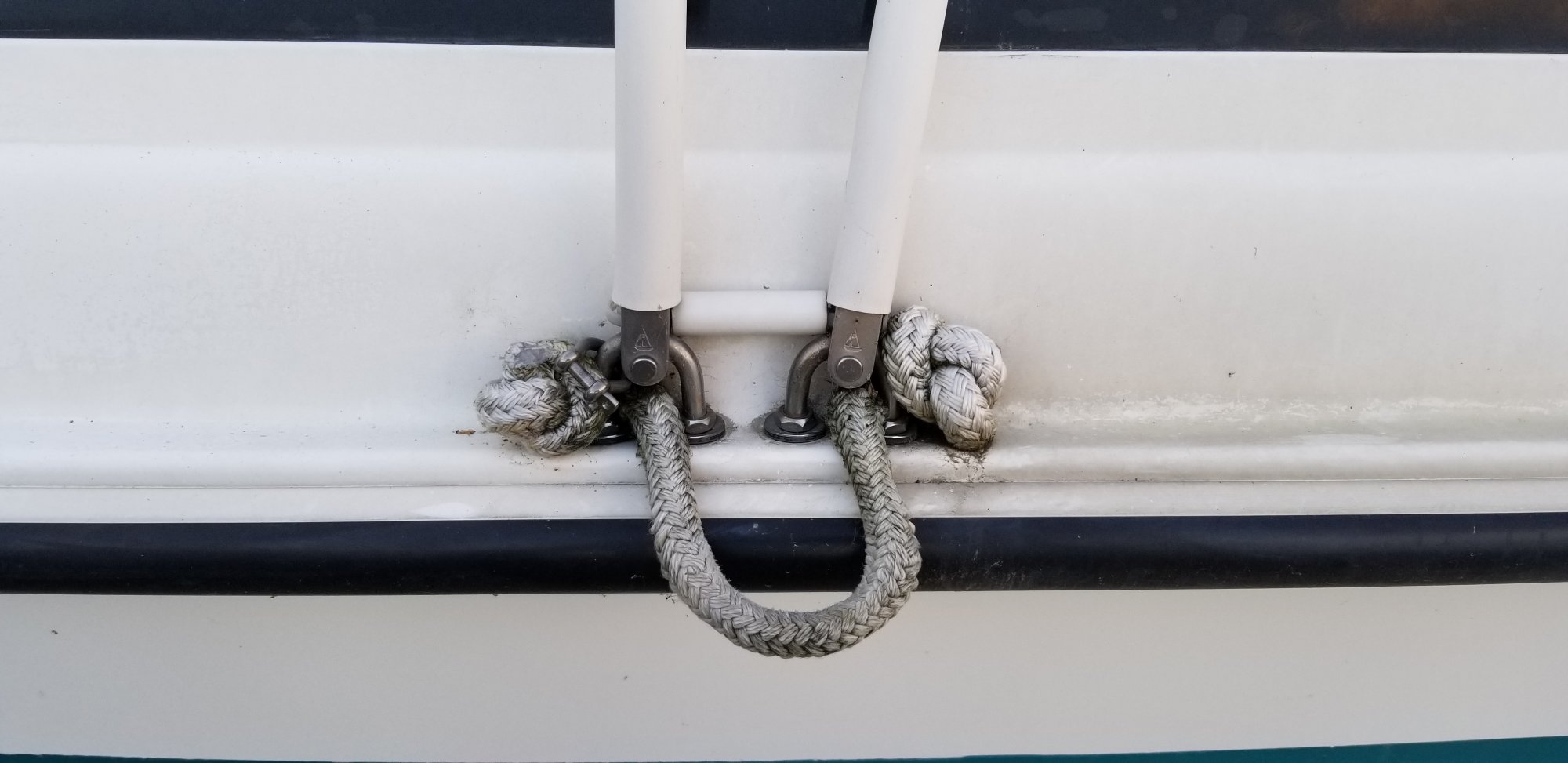

I put a little loop of line between the u-bolts of my shrouds. From there I run spring lines fore and aft to cleats on the dock near the bow and stern. The line was a bit chaffed after 15 years so I replaced it a few years ago. It was a temporary measure but I've had it this way for 18 years now on a dock
that is totally exposed to wind and waves on a small 1 mile by 7 Mile Lake.

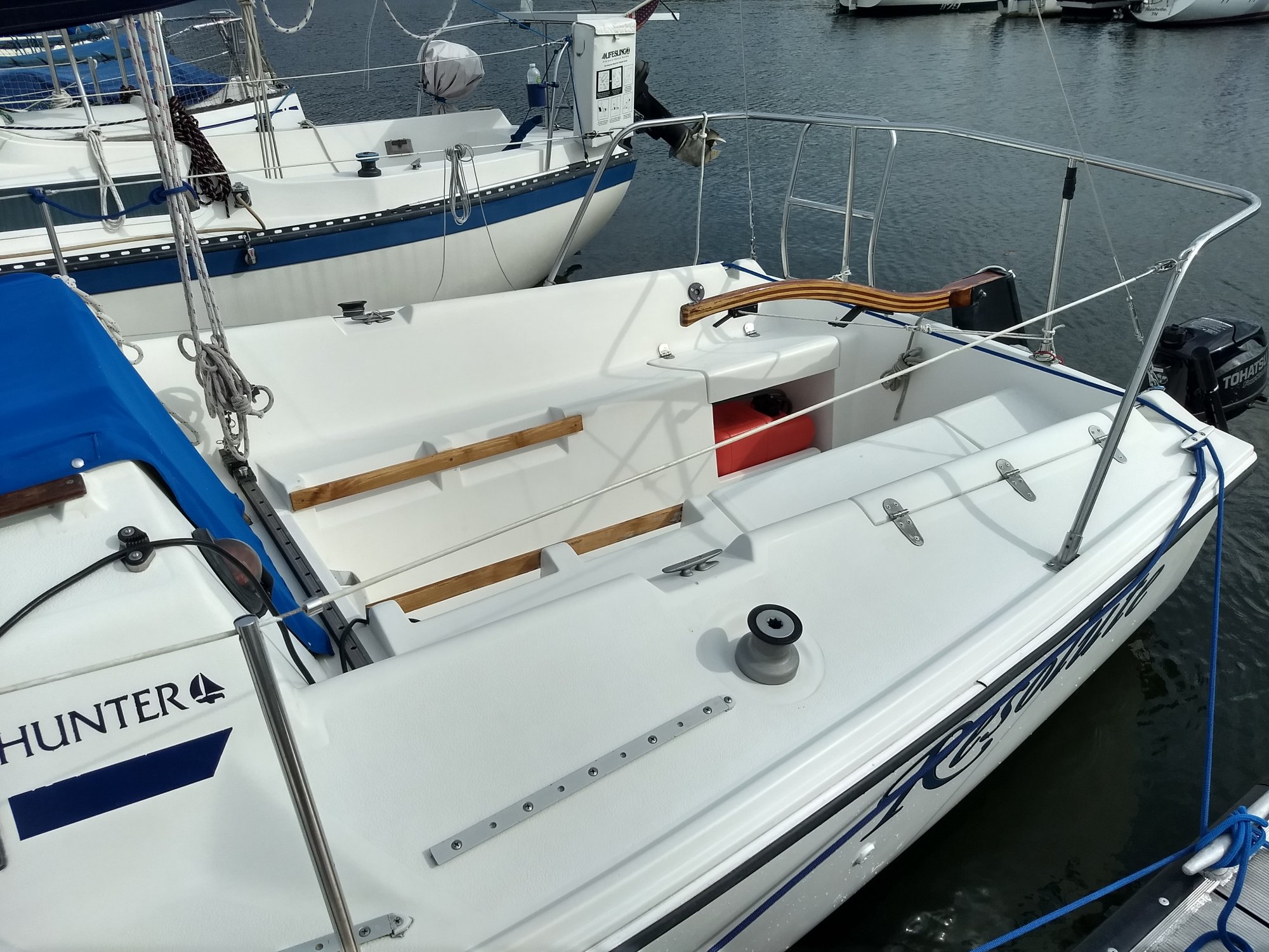

I wasn't able to find a picture. I can try to remember to take on this weekend. I just used a cleat identical to the ones on the back of my H26. I drilled holes just like the chain plate but back close enough to the cockpit that I could reach the cleat easily. I put in a chunk of aluminum on the bottom similar to the way the chain plate is done. I trimmed some of the fiberglass underneath to make that fit.
