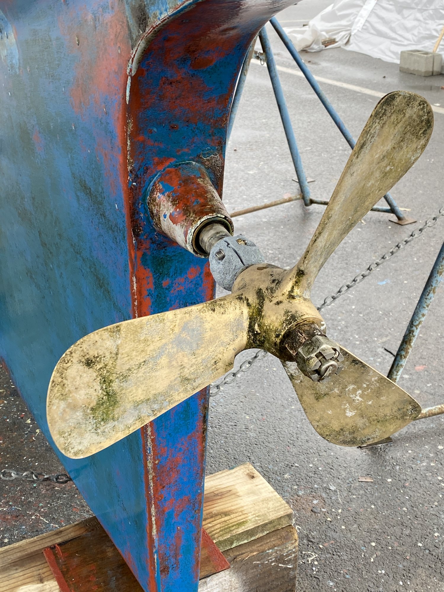

I inherited this prop on the boat
Working with a prop shop I installed this
Great improvement in engine performance and thrust. (1.5knots). Also a .9knot improvement in sailing
Seek out an expert over a catalog. I give high praise to WestbyNorth and their CampbellSailor prop design.

Interesting... the top prop looks more like what you'd see on a correct craft instead of a sailboat... what's the numbers for them... diameter and pitch?
  • Ha
23,808
I do not know the pitch. I can check the diameter. It is stored in my garage. I was thing of using it as a dinghy anchor.
