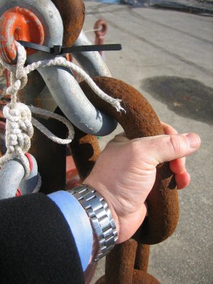

This is my bottom chain for a 36 footer..

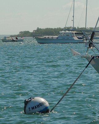

The ball below marked "Mahoney" is my boat neighbor. I was on board when we had a lull and wind shift. His boat gently moved around the ball and the floats kept the pendants on the surface but circled around the ball. As soon as the wind came up from the other direction and the pendants tightened they were immediately sucked down and into the chain because they were caught under the waist. I took the photo the rowed over and untangled his pendants..

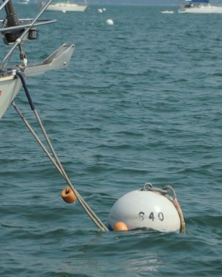

Above ball tangle with floats:
Another one:
Oops another:
Pendants:
Keeping the shackles in a constant plane, no drooping, is something many mooring installers over look let alone boat owners. It is perhaps one of the single most important aspects to prevent bellow the ball pendant chafe & wraps. The floats should be doubled or have enough flotation to keep the shackles in the same position whether the boat is pulling on the mooring or just sitting idle.
Double floats that remain under the ball & below water keeping the pendants against the under side of it, not out away from it, keep the shackles under constant tension & never let them droop or tangle. I have been lacing pendants like this for well over 12 years and not once have I had a chain wrap or shackle chafe. You also need to continue them to about 4-6 feet from the ball but the most important floats are the ones under water pushing up against the underside of the ball.
