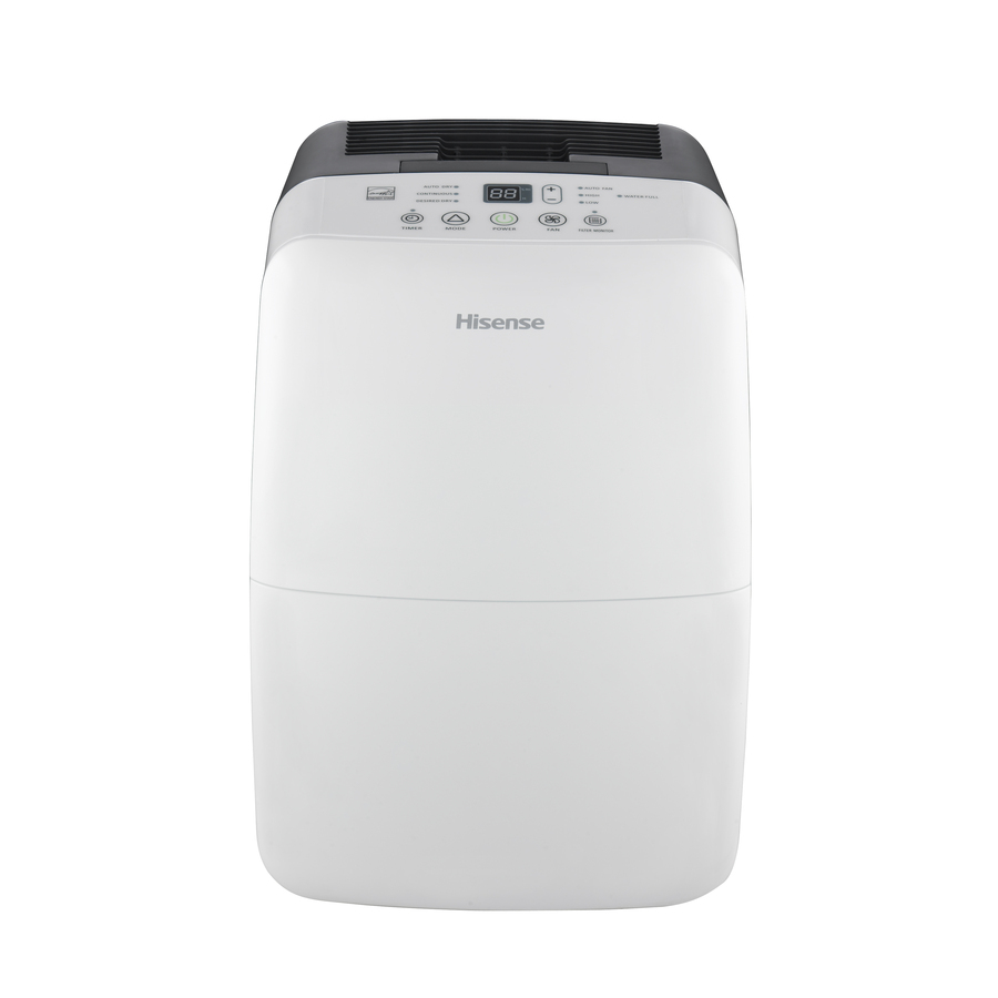

I bought this one last year. It uses electricity, but has kept the boat free of mold and foul smell this winter.
  • Remove 35 pints of moisture per 24 hours
  • Adjustable digital humidistat for precise humidity control
  • Will work in cold environments as low as 38�F
  • Bucket-full indicator
  • Easy roll casters for easy portability
  • Large digital LED and controls
  • Optional hose use for water elimination
  • Washable filter with filter monitor
  • 24-hour on/off timer
