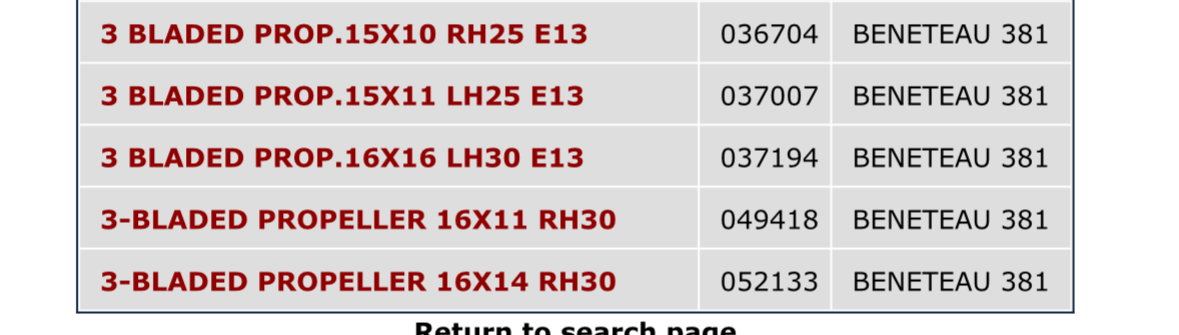

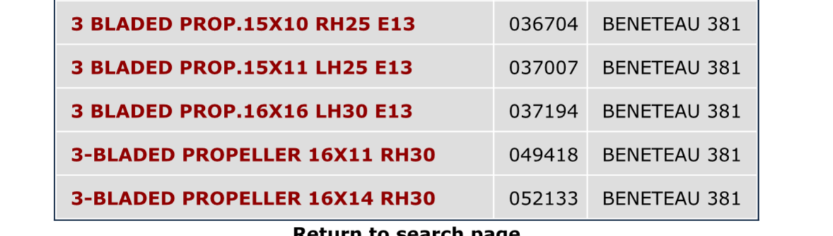

The Beneteau spare parts site lists all of the following possibilities for the 381 -
I presume those vary based on model year and engine, and maybe other factors. Ward might know which one goes with which, but I think a prop manufacturer would be a good bet to size their specific design relative to your specs.
I presume those vary based on model year and engine, and maybe other factors. Ward might know which one goes with which.
Well, if you are certain of the shaft diameter (25mm or 30mm) and know if your old prop was right hand or left, that narrows the options to one or two. As @Davidasailor26 mentioned, looks like it was dependent on date of manufacture and engine /transmission combination.
On my '05 model, Ward was able to look up the "build sheet" & send me a file, including the prop that was used as well as options such as engine, keel option, upholstery option, etc.
