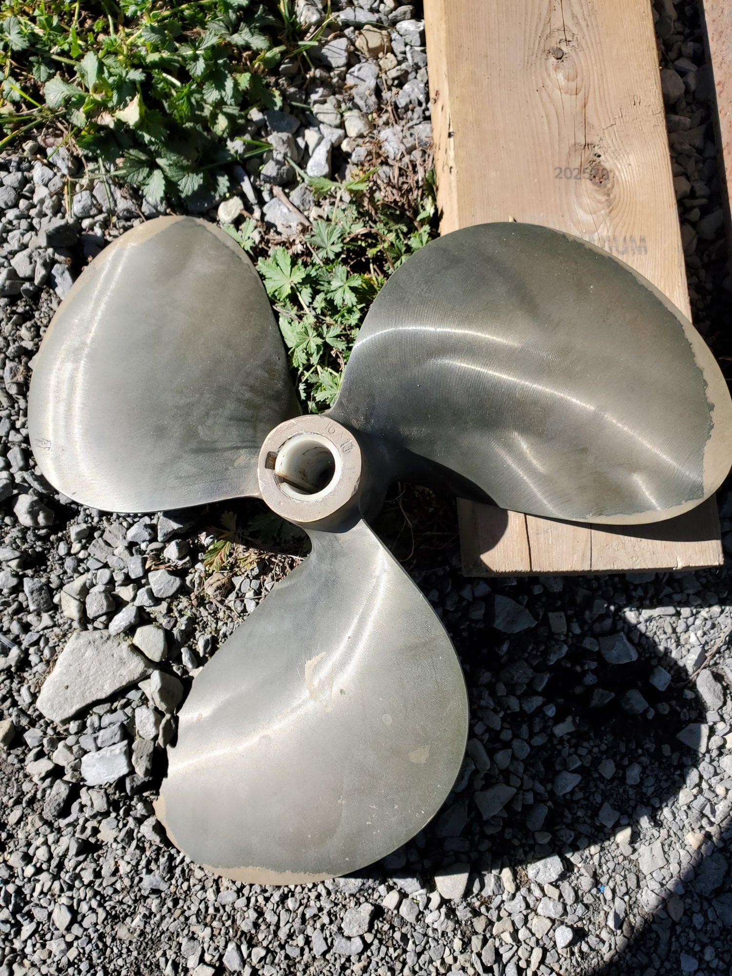

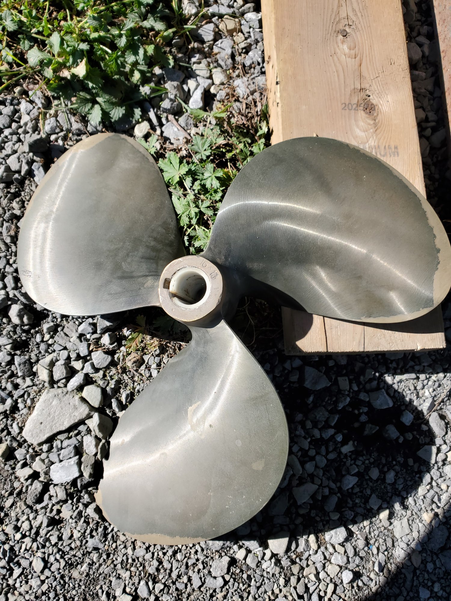

So the weirdest thing about my situation (but not completely surprising considering some things I have found on this boat) is that the prop that came installed on the boat was for the wrong sized shaft. I didn't measure, it might be a 1-1/4" and I have a 1" shaft. Whoever installed it made a shim out of what appears to be PTFE. :yikes: I was, to say the least, questioning this setup.
The previous owner said he thought the 3 bladed prop that was on there was a bit too big and gave me the original 2 bladed prop. I did find I could not get max RPM out of the engine and was not getting the same speed under power as other people with the same boat and engine. I am now very glad I decided to switch the prop, I don't know how long that shim would have held.
I'm guessing the PO got the 3 blade for a good deal and decided to try it.
Anyone want a 3 bladed 16x13 prop for a 1-1/4" (ish) shaft? I certainly have no use for it. Free shim included :)
