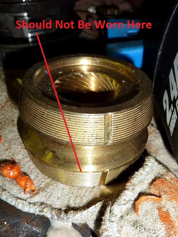

I have spoken with them at length about this and also seen the cones of a gear box that needed re-building due to locking the gear. The guys who report they can't get it "back into neutral" "without starting the engine" are specifically why this MSA was created.
If it locks up you should never "force" it back to neutral and should always start the motor in reverse then switch to neutral. Yanmar does not make these MSA's on a whim. Reverse is used so limited that wearing out the cone is rare from locking but the prop does not simply load up the cone and always bury it into the reverse gear especially at low sailing speeds. It can cause the cone to chatter in the gear which can cause undue wear.
The cone is an aluminum bronze alloy and the reverse gear is iron. The cone gives not the reverse gear. After a while of this loaded chattering the cone can wear to a point where you may have problems. When you put it in reverse the motor can tend to feel like it is "hopping" because the cone is slipping until it has been driven deep enough into the gear to lock up and stop slipping. This MSA is more about the problems surrounding the ability to not get it out of gear than anything and the resulting damage that can ensue if trying to force it back into neutral.

This was a cone clutch from a full keel boat. They had a fixed two blade they locked in reverse. The motor began bouncing violently when put in reverse as the cone was apparently slipping and not fully engaging. The cone was worn according to the re-builder on the reverse side of the cone. They usually see the forward side worn. Motor had 1400 hours.
