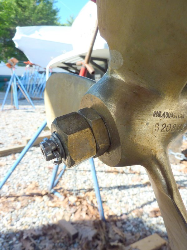

Can’t beat the configuration shown in your photo; that prop isn’t going anywhere!
Jan 4, 2006
7,770

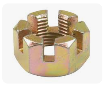

The prop lock nuts on my boat (99 H-310) are actually a step up from that one. The thin nut goes on first and is torqued up to the correct torque against the prop. That's not moving come hell or high water. The next nut is a castle nut :
.................. and it's job is to prevent the thin lock nut from ever moving. The beauty of this little beast is that you turn it up against the thin lock nut until it's snug. Now you split the difference. If two of the recesses don't quite line up with the hole in the shaft, you reef on the nut until the two slots DO line up with the hole in the shaft, probably slightly over torqued but no harm done as long as your sensible about it. If, on the other hand, it's jut too far to torque to line up the holes, back off slightly until the holes DO line up. It's still up against the thin lock nut, maybe just not as tight as you'd really like it to be.
When you're installing the castle nut, it's not as bad as it sounds as there is sufficient slack to go either looser or tighter if you're right in the middle of the slots and still be up against the thin lock nut.

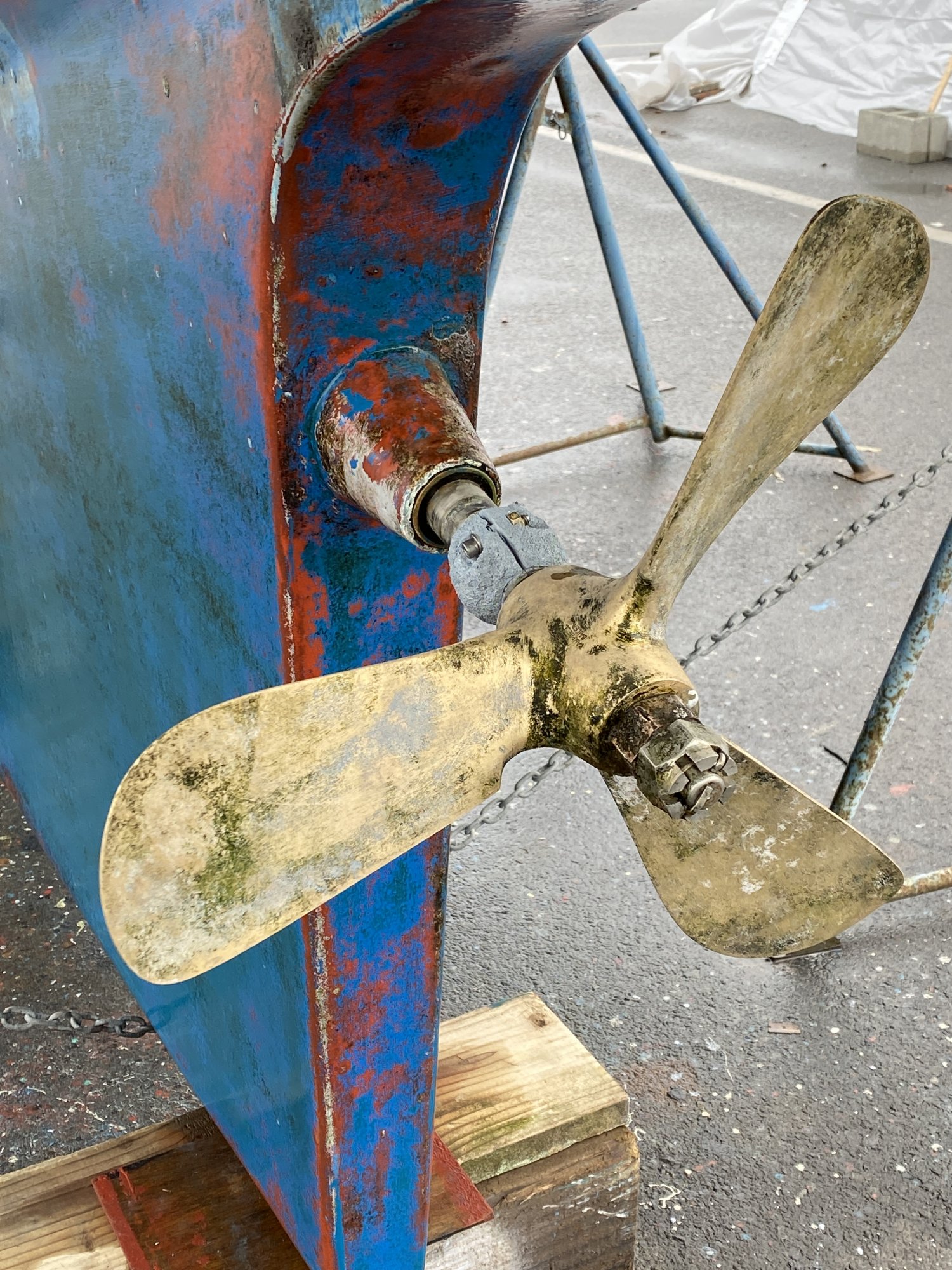

I purchased a Campbell Sailor 3 blades prop from WestbyNorth for my 35ft Cal Cruiser. I’ve written about the experience several time here on SBO. I am a believer in the quality of this prop and the improved performance achieved.
Pictures of the prop design.
The original Michigan Wheel 1-2knots slower both under power and sail.
The new Campbell Sailor prop after 5 years in the water.
Contact WestbyNorth.com. Speak with the engineer who runs the shop. He guided me through the process. Answered my questions and delivered what he promised.

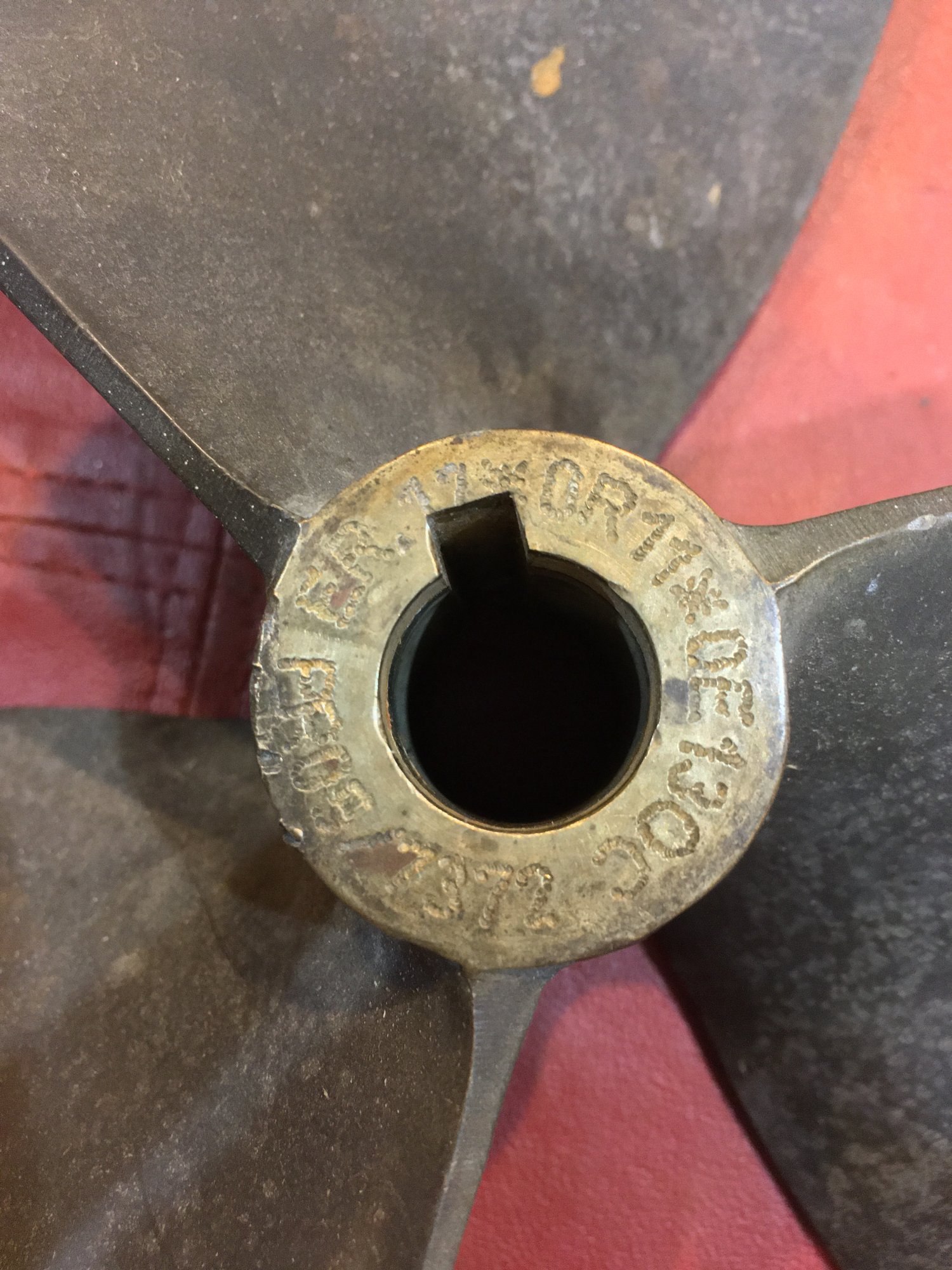

Probably not going to see that info unless the prop is cleaned. In some cases, like mine, the data is inscribed on the flat surface of the prop where the nut is. Surveyor is not going to clean prop or remove prop to obtain the identifying information.

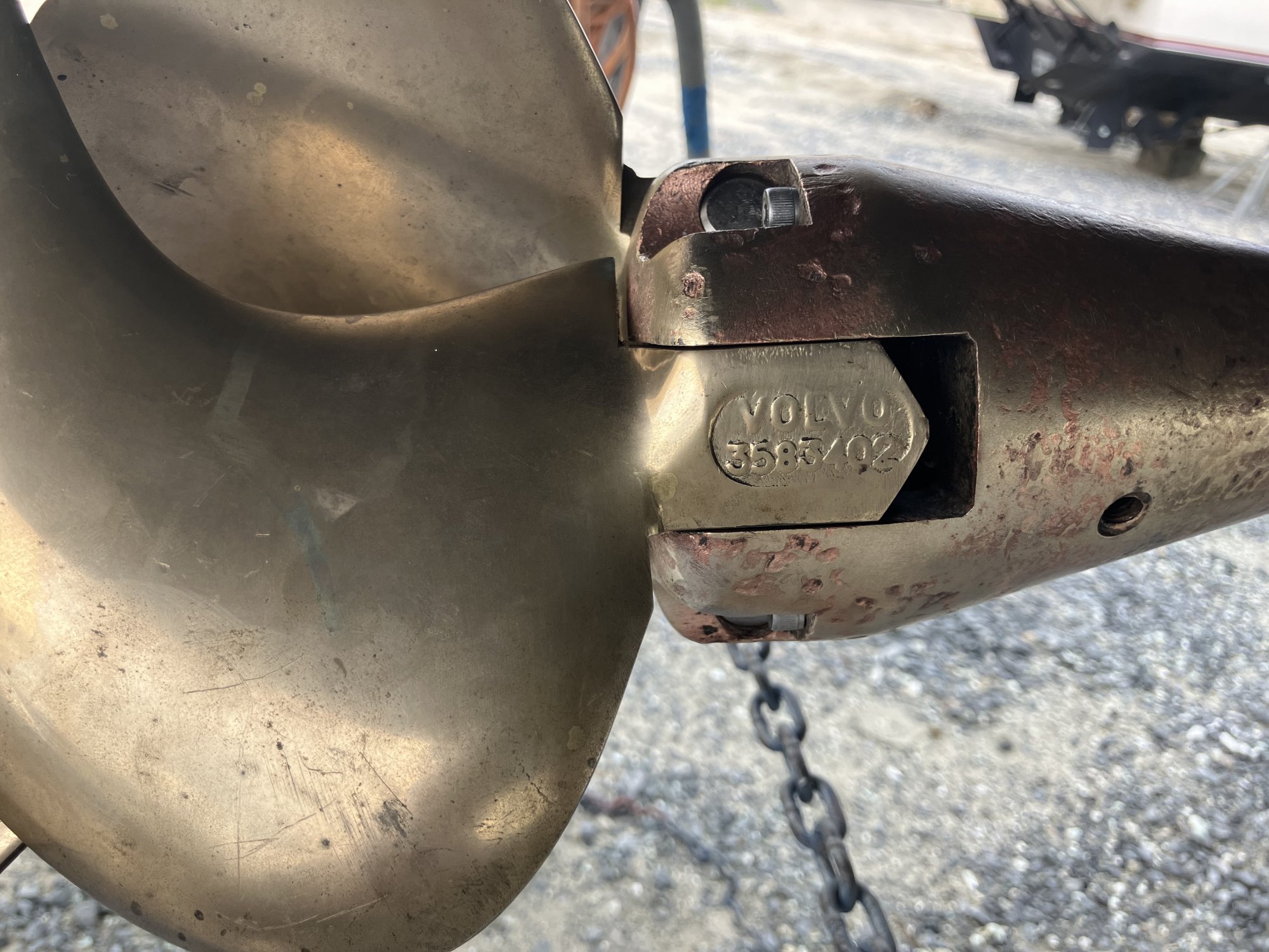

This is the original 17” dia x 11” pitch prop that was from BeneteauIMG_2354.jpeg
This the 17” x 12 Volvo prop presently installed
